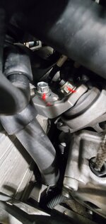

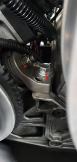

Just finished my install this evening. I went from around .100 leadin to now .026. Install was pretty straight forward. Text Tony @TRS some questions expecting an answer in a few days and my phone rang 2mins later from Tony. ON CHRISTMAS! Talk about customer service! He clarified a few of my misunderstandings about the install mainly my more technical questions regarding the proper way to make all the proper alignments as my clutches were lightened and balanced by
Patricks Custom Carbon. There is .070 of material removed off the stock clutches which you need to take into consideration when using the TRS tool for alignment, float and leadin.
I didn't take the before pics but as you can see I had to move the motor as far forward as possible in the TRS MAG side mount. This allowed me to not only get the leadin within spec which read ridiculously out of spec but I was about to reduce the amount of washers I had to run on the back of my secondary.
