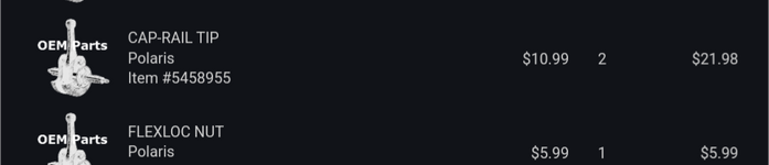

Babbits has 10.99 rail caps, I did use the wrong term in my original post.
Those should be correct but they will require some modification and you will need the corresponding spacers as well to make everything fit together property.
I just ordered the Ice Age Tip Fix Kit which comes with everything you will need without having to modify the 2023 rail tip or source each of the spacers.
There is no modification of the rail tip needed. Cut the hifax 3" from the mounting bolt add the spacers on the outside, cut the tube on the inside your done fore $32. The ice age kit is factory poo parts.
The 2023 Polaris factory rail cap is different then the one in the Ice Age Kit. The 2023 Factory ones have a small hoe on each side and the Ice Age ones have a large hole. I should have clarified better, as there is some modifications required if you just order the 2023 Polaris factory, meaning cutting the tube like you said to allow for the extra width of the rail tip.
I just decided to do the Ice Age, as I trust them and no measuring, cutting or anything,.......just install and fit! But yes, either way is a fix for sure!!
22's have a small hole , 23's have a larger hole. The 22's use a 6mm bolt . The 23's have a 17.5 mm hole in them. I haven't measured the shaft diameter on a 24 but the spacer on the 23 #2 is 17mm in dia.

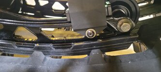

Anybody noticing shredded end caps on 22’s? I’ve looked at 6 today and all the caps are shredded bigtime.

Pic's? Seems interesting. Track pitch have anything to do with it?
You’ll have to trust me. Not fake news. I either left my phone at the puzzle table or the make shift pickle ball court. I have obviously given up on life with this no snow BS and supporting Polaris. All sleds less than 500 miles. The 23’s looked okay.IMG_3952.jpegIMG_3590.jpeg
