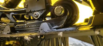

Not sure if this is anyone on the forum or not but I cam across this on Mountain Sledder Swapmeet. Someone looking for a replacement rail, looking like they lost a hyfax and did some damage.
Yea that’s my cousins. He’s on Snowest, not sure how often he logs on. His iceage tip kit hasn’t arrived yet and he was riding this weekend when the hyfax ripped off. Snapped the screw head off. Had to ride it that way back to the truck. He’s going to work on a warranty rail and his iceage tips to show up but I said he could get the screw tip out, replace it with a through bolt so he can keep running his sled without a new rail. He said the bottom of the rail isn’t terribly worn and track clips look ok yet.

Hi, new forum member here. From Ishpeming MI, new 24 9R. Saw issues with hyfax mentioned on line, ordered Iceage rail kit, haven't received it yet. Checked with dealer regarding rail issue, response was that Polaris said "that's our design for '24" Got 3' of fresh snow Friday/Saturday last week, scheduled for knee surgery on Monday, so I figured I had a small window to ride new sled. Checked hyfax bolt torque and cut a curve into the exposed end of hyfax. Rode sled 7.6 miles, found right hyfax wrapped around rear axle, sheared off hyfax retaining stud. Dropped at dealer, they are trying to warranty repair rail as it sustained damage. Dealer says both the orange rail and replacement hyfax are on backorder. No mention of a design fix. Ice age emailed today that their kit is about to ship. Hoping repair and design fix is complete by the time my knee heals. Glad I havent sold my Arctic Cat as I hopefully will be able to ride that.
