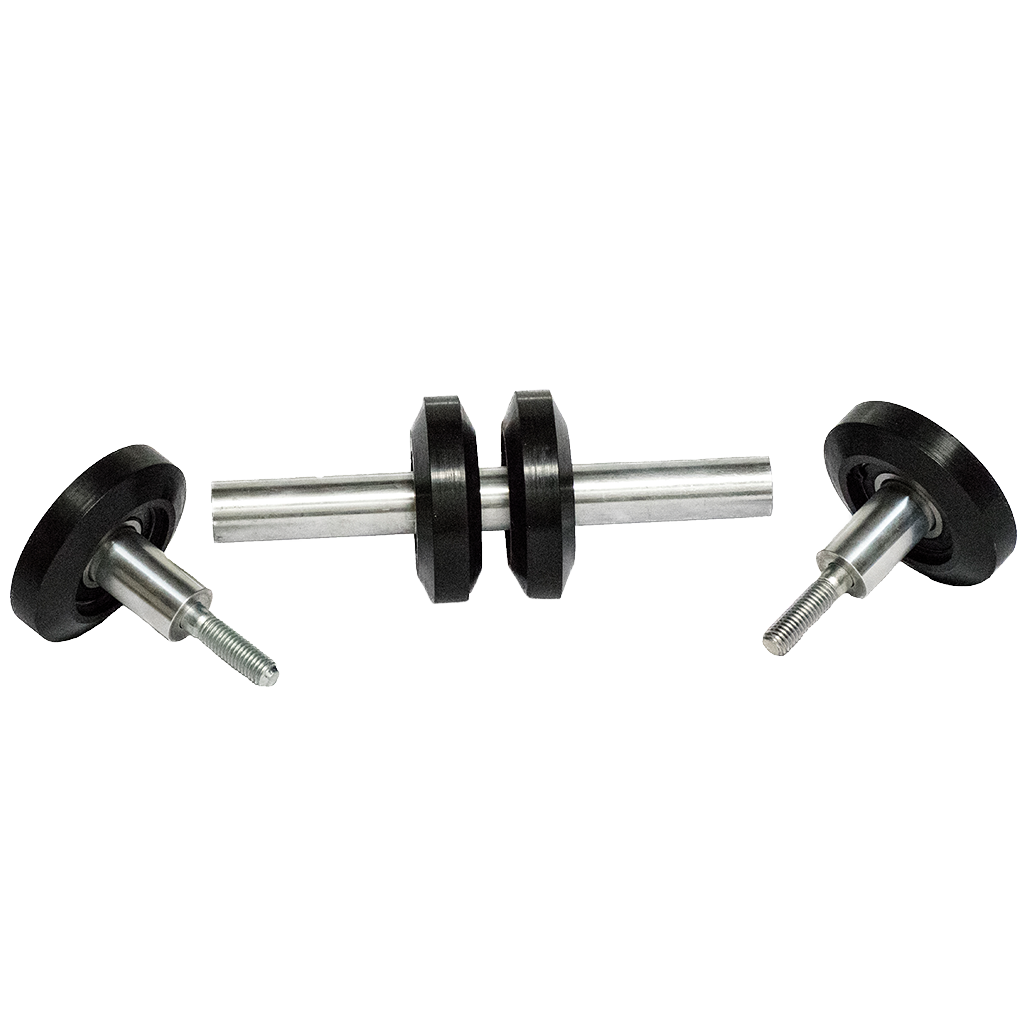

The anti-stab wheels on the 24’s are also different. I want to measure to see if they are the same diameter as the 23’s.

I have a 23 and a 24 in the garage. 2024 wheels measure around 3” and 2023 wheels around 2-9/16”.

Not to rain on anyone's parade, but guys are reporting using the '23 anti stabs with no or very little modification and those cost $10 each 🤷🏼‍♂️
2023 anti stab wheel diameter is 2.5" vs the the 3" diameter for 2024 - this is a downgrade and more expensive - $145.91 for the assembly w/ tips from babbits.
I already tried 2023 tips by themselves - they don't work without spending serious quality time with a dremel, and you would still end up with a loose oval-shaped hole. Why take a chance when tracks are $1500+?
I don't know what you mean. As long as u get the bushings as well as the rail tips from a 22 or 23 they go right on. Cut the front of the hifax off 3" from the center of the bolt hole that holds the hifax on the rail. Install bushings and rail caps and done. 10 minute job that Polaris should have done at the factory. Some one should be fired!!!
