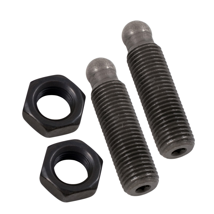

A 5/16-24x1 screw with a round point should be an easy fix, below is a pic of a rocker arm adjuster unfortunately it's a 3/8-24 with a 5/16 ball, I'm thinking this could work.
If those are steel I don't think they will improve on the stock bolt.
