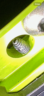

Hyfax Rail Fastener
FYI
My 23 Khaos 163 has both rail screws centred with no issues and in my opinion is what we expect and deserve for that amount of $$…
i can't believe we are dealing with this. huge step backwards for such a simple thing.
i bet the bean counters eliminated the "unnecessary" part to save 50 cents a sled.
this is going to cost them in warranty repairs.
this will be the next stop ride/recall. guaranteed 🤦🏻
