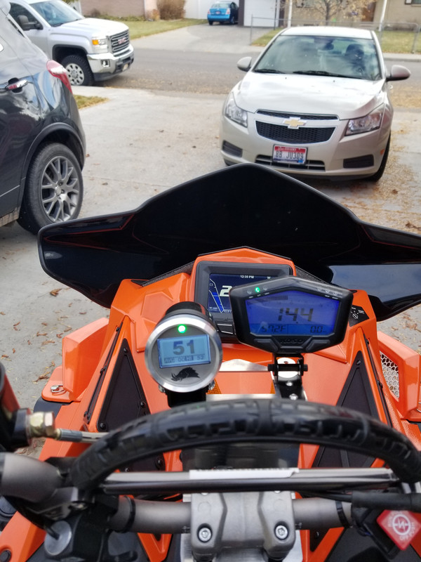

The gauge I have is a Koso X2 (AFR, boost, temp), the one on the right.
