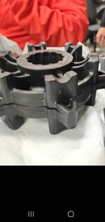

What my group has see on 5 23 turbo r, and 2 24's is drives skipping even with a crazy tight track. Reeds and rollers going at about 1200 miles. We all got the new 25 skidoo drivers on warranty over the last 2 weeks, and there way way better. They look double the size.

What my group has see on 5 23 turbo r, and 2 24's is drives skipping even with a crazy tight track. We all got the new 25 skidoo drivers on warranty over the last 2 weeks, and there way way better. They look double the size.
So the warranty was based on just the skipping complaint? Much pushback from brp?
Yup, complained to the dealership about skipping a few different times. They ordered up the 25 drivers and nothing but happy with them. One friend even got his 24 freeride track covered under warranty, because it broke all the track rodes from having to be over tight.
