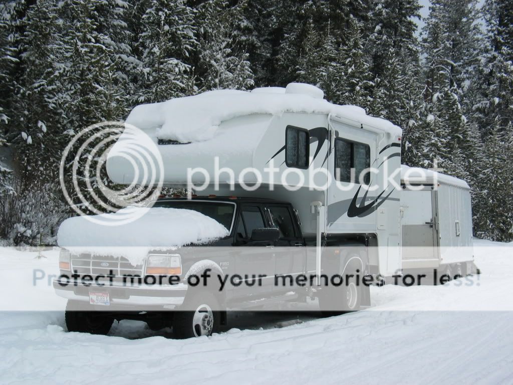

Greetings Sledskiing,
Good for you and yours sounds like a nice upgrade from your pop-up to the bumper pull!
Hard to beat a Honda generator we have one as well, remember your generator rating is based on sea level. Minus approximately 3% for every 1K foot increase in elevation. Whatever the combination of AC powered goodies you go with keep track of your total wattage.
Our camper is equipped with a modest basement with a height of 10" the camper furnace is advertised to heat the basement, but I suspect most manufacturers as a general rule don't design their RV's for extreme cold. We are uncomfortable with the risk of filling our domestic water tank so, we load our domestic water tank with approximately 50 gallons of -50 RV anti-freeze and pump the liquid throughout the camper plumbing, minus the water heater. (The domestic water tank is flushed in the spring with a series of Clorox and vinegar treatments) This allows us to use the camper sink, toilet & shower all season long. We drop toilet vitamins in the black tank just like summer time use. We pack water and use a Zodi Hot Water Shower Mate for comfortable showers. After the shower we dump a cup of RV anti-freeze down the drain to displace the water in the p-trap.
Our shower and toilet drain into the black tank. This is not scientific I but I've used my automotive anti-freeze test to check the -50F RV anti-freeze and sure enough it tests out at -50 F. I've then checked a 50/50 mix of RV anti-freeze and water and it check out at -25F. So I've felt comfortable adding a few gallons of shower water to the black tank.
Our coldest camp out so far is -25F and vehicle speed as we drove toward the trail head averaged 30 MPH. So don't forget the chill factor when traveling to your favorite snowpark. We were east of Cascade, ID at the Warm Lake trail head. With the temperature we experienced that night and the chill soak on the camper structure even with the AC heaters and generator running the camper furnace (30K BTU) ran non-stop for 5.5 hours.
Keep in mind that batteries as they charge and discharge give off a gas, that is why manufacturers mount their batteries outside or have an exterior door with grills to allow a path for the gases to exit. If you’re going to the expensive to add a battery consider going with two (2) six (6) V. DC. batteries wired in series.
Offered for your consideration -
An electric mattress pad or blanket with two temperature controls.
We have two AC heaters with tip-over and heat protection shut-offs securely mounted in the basement of our camper and set at 45F.
If you have an air conditioner don’t forget to check that potential heat loss source as well.
One AC heater in the camper set at 65F and the camper furnace set for 60F. To feed our electrical habit we run a Honda 3000 we can get 10 to 14 hours of run time on a tank of fuel depending on the ambient temperature.
Plug/cover every roof vent from the inside we purchased foam insulation and cut-out the sizes needed to press into the framing around the roof vents. Anything with a plastic cover on it is insufficient for winter time camping. A good example is the plastic door covering the port to add water to your domestic water tank. We place a piece of foam insulation behind the plastic door. Home depot sales a bubble packing wrap with aluminum skin on it and we cut pieces as needed to cover our windows. Using small pieces of velcro to secure the coverings. The down side is it sure makes the inside of your RV dark, so we remove the window covering from the table area in the mornings. We don't use our hot water heater so there is an exterior cover that is made from tin with grills cut in to, we plug that bad boy as well.
It was great to read your question about winter time camping. It was 100F in Boise, ID yesterday....winter can't get here quick enough!
Happy Winter Camping.
http://i474.photobucket.com/albums/rr101/4gr8x/Stanley2007062.jpg
