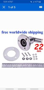

Not sure if anyone will see this but a question for those of you that are using a thru-hull fitting and venting your diesel heater exhaust out the side wall of your trailer -- over time are you seeing exhaust 'soot' build-up on the wide wall?
[mention]MikeMetzger [/mention] the one in the trailer isn’t right? It’s vented out the floor though…

Looks nice. I know the heaters come with an exhaust pipe meant to go through the floor but I was considering routing the exhaust out the sidewall possibly, depending upon where I end up placing the heater, so my kids can use the exhaust to warm up their hands while we outside the trailer. Plus, I have some concerns that venting the exhaust out the floor will cause the pipe to rust out quick from salt. Maybe I am overthinking it - I tend to do that - haha. Seems like the exhaust pipe that comes with them are pretty cheap though. Mind snapping a few pics of your exhaust below the trailer? How about your tank setup? I was also considering mounting the tank outside. Did you thru bolt the tank to the studs of your trailer or just secure them with self-tappers? It's my understanding that a mix of kerosene and diesel will help reduce gelling. Thanks for the reply!
We’ll get some pics. As far as salt, I’d say out the bottom/side/top will all still be swamped with salt spray if your state still uses salt. Not sure I’d worry about that.
I ran mine out the side of the trailer and going on its 3rd year so far so good. I also mix diesel with kerosene seems to help it burn better at elevation and also helps with jelling.

Gotcha. I cant decide where the heck I want to mount mine. I have a 29' v nose with front and rear ramps. I am worried that it will be in the way if its on the floor. The trailer is new to me so I will probably test fit the sleds in it and then decide. I still really like the idea of routing the exhaust through the wall so m kids can use it to warm their hands while outside the trailer if need be. Not to mention it just seems like a better more professional install IMO

This is kind of what I had in mind; mounting it high on the wall. Although I won't be ducting, at least not for now, so I would just extend the duct low so I don't end up with a hot ceiling and cold floor. How long has he had the exhaust run through the wall? any issues with soot on the side of the trailer?
