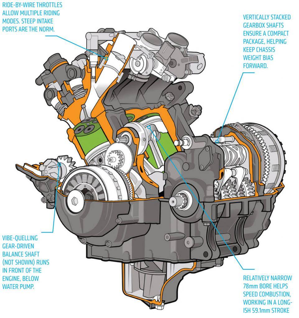

Hoping Yamaha delivers us a new Cross Plane engine..
Published on Jul 15, 2013
The crossplane or cross-plane is a crankshaft design for V8 engines with a 90° angle between the cylinder banks. The crossplane crankshaft is the configuration used in most V8 road cars.3d model of a cross-plane crankshaft demonstrating the 90 degree angle between the crank throws and the large counter weights.The crossplane crankshaft has four crankpins, each offset at 90° from the adjacent crankpins. The first and last of the four crank pins are at 180° with respect to each other as are the second and third, with each pair at 90° to the other, so that viewed from the end the crankshaft forms a cross. The crankpins are therefore in two planes crossed at 90°, hence the name crossplane. A crossplane crank may have up to five main bearings, and usually does, as well as large balancing weights.
Crossplane V8 engines have uneven firing patterns within each cylinder bank, producing a distinctive burble in the exhaust note, but an even firing pattern overall. Their second-order balance, owing to the 90° bank angle and 90° throws, means no additional balance shaft is necessary to achieve greater smoothness. Without the 90° bank angle, a balance shaft may be required.
The other prominent design for a V8 crankshaft is the flatplane crankshaft, with all crankpins in the same plane and the only offset 180°. Early V8 engines, modern racing engines and some others used or use the flatplane crankshaft, which is similar to that used in a straight four or flat-four engine. Flatplane V8 engines may use any angle between the cylinder banks, with 60° and 90° the most common. They lack the V8 burble and the superior mechanical balance of the crossplane design, but do not require the large crankshaft balancing weights. Inherent balance of the big ends is like a straight four, and modern designs often incorporate a balance shaft for smoothness. But without balance shafts, flatplane designs have the least flywheel effect of any V8s, which allows them to be more free-revving.
The crossplane design was first proposed in 1915, and developed by Cadillac and Peerless, both of whom produced flatplane V8s before introducing the crossplane design. Cadillac introduced the first crossplane in 1923, with Peerless following in 1924.
Inline-4 engines can also use the crossplane concept. The 2009 Yamaha YZF-R1 motorcycle uses the crossplane crankshaft and, in the absence of the 90° bank angle of the V8, must use a separate balance shaft geared off the crankshaft to eliminate the inherent vibration (a primary rocking couple) found in this type of crank.
A crossplane crank has been used in Yamaha's M1 MotoGP racing models in the past. Yamaha claims advances in metal forging technologies make this a practical consumer product.
