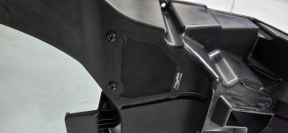

There is a piece of plastic behind that back round vent inside that will need to be trimmed off or else its closed off from the rest of the intake. And the back little part that sandwiches the intake together will need silicone on the outside since it doesnt tuck into itself and create a seal.
And the stock under hood vent, cat installed a flapper plastic piece to it. It seems like its super tight and wont open much to even let under hood air in...
I just noticed that.
If the flapper don’t flap I wonder how much difference it would make good or bad with sucking hot air just to remove the flap
Was thinking of just pulling on it a bit to keep it cracked open a bit all the time?
