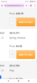

B BlueDevil Well-known member Premium Member Artic Cat Klim Kmod Jan 26, 2025 #1 So how many exhaust springs are supposed to be on the y-pipe to pipe connection?
A arcticridr Well-known member Lifetime Membership Premium Member Artic Cat Klim BCA Jan 26, 2025 #2 Country cats microfiche shows 4 Attachments Screenshot_20250126-211203.png 148.5 KB · Views: 1
