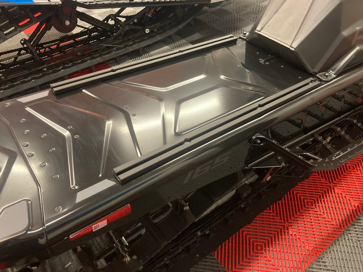

I contacted them a few months ago, doesn’t sound like they are coming out with anything new. Going to need to retrofit what we already have available.How about Mountain Addiction? I've been running a MA set of rails for gas and storage for the past 8 years on my Polaris sleds.
You can.Why can’t you use the original mountain addiction rails on the matryx?
The existing Polaris rails used the T Slots in the tunnel to mount to. The Matryx tunnels do not have the T Slots. An option is to simply drill holes and mount them directly to the tunnel.Why can’t you use the original mountain addiction rails on the matryx?
i saw next level has a rail kit that bolts on the matrix so you ca use anything you have on a axysI contacted them a few months ago, doesn’t sound like they are coming out with anything new. Going to need to retrofit what we already have available.
Can you post a link. I'd like to check it out.i saw next level has a rail kit that bolts on the matrix so you ca use anything you have on a axys
Ive run the same mountain addiction settup on my iqr all the way to my axys rmk. Why is everyone making this so complicated?You can.
There’s no coolers under the tunnel past the seat.
Literally ANY gas can attachment made for sleds will work.
Found the Next Level T Slot solution for Matryx sleds
Skinz T Slot Rail Adapters for Matryx
These T-Slot Rail Adapters allow you to use your Skinz QR tunnel paks and Polaris t-slot mounted tunnel bags on Matryx Chassis tunnel. Attach these to factory provided mounts and you are all set to go. -18' long for 146/155 -24' long for 155/163/165 Fitment: Fits all RMK Matryx Tunnels Note...www.nxtlvlshop.com
