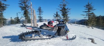

View attachment 429499what can you guys tell me about this machine. Would you pick this or the black special edition shown in this thread? The expert looks like it has better shocks, has the adjustment limit strap. Not sure if it has the seat with belt holder? Is there a place to store a spare belt on a doo? Never owned one but thinking of getting this for my 2nd sled. I also have a 9r pro 155. Can't decide between this blue doo or a 165 boost pro or khoas. 2k off on doo and 0% interest is the deal. No set up or freight fee.
That's a fair deal. The mid season release is an Adrenaline with Edge package. Pretty different sleds. The mid season release has some goodies on it the Expert does not have. The edge will have T motion, which I prefer. Sled is way more playful. The biggest difference is the running boards. The Edge has the SP style running boards. Didn't think I'd care for them, but did great, even on deep days. If I could get the above sled as an X, I would do it. I don't care for the Expert. I've owned both, prefer the T motion hands down. Not to mention the mid season release is an awesome color.
