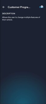

I just went and connected to our 22 boost to show the navigation through the screens. This should help with finding the functions.

I was on the phone with tech support for about 20 minutes and they got the functions to show up. The WG and EV functions were performed. Thanks Bobby
