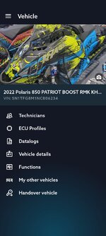

No functions came up for my 2022 Boost but they did on my 23 gen 5.
I sent you a message let's connect and see what is happening with your boost. It should pull up all the functions for that. This is one of our test sleds, also a 22 boost
Screenshot_20231219_091910_Auto Agent.jpg Screenshot_20231219_091917_Auto Agent.jpg
