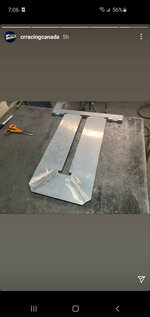

it's not extending lower than the exchanger?
Yes, for sure it does - very similar to how a stock sled has an angled extension that the tail light and snow flap mount to. This will kit will protrude a bit further down than the OEM pieces.

You realize the track will hit your “invention”?
once you actually shorten the tunnel.
It's a XP cooler off a 154". Found the skid/bulkhead for free, as funds are tight and the MTNTK cooler was to $$$ for us canucks.
Pressure tested good, and we will see how the top side adds in for cooling.

bahahahaa .. how / why the frig did you put a doo 16" wide bumper on a 15" tunnel

Found a next to new bumper for $ 20, figured the upswing on it would be nice to have.
Sectioned out the bumper to 15-3/4" and plug weld and tigged her up. Pretty hillbilly up in here lol. Just need to trim the rear skid to match bumper and she will be buttoned up today !
I don’t believe this will be an issue but we will double check for interference. Thanks for the input!
Check the pictures in the mtntk thread where a guy destroyed his with track contact........
Check the pictures in the mtntk thread where a guy destroyed his with trach contact........
Interesting.. Thanks for bringing that to my attention - it looks like it mangled the aluminum shroud an broke the adhesive seal causing a leak. This setup will be much stronger and should stand up to that but why design something that is known to have interference... back to the drawing board !!
