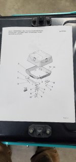

What are some ways everyone has mounted a rigid box/ pelican case/ or similar to a matryx tunnel. Looking to mount some type of box on my 23 RMK, and unsure about going with the JDSCustoms packout mount plate or doing something a little cheaper. Thanks!
Amazon box, 1.5”x2” plastic from local wholesaler, handfull of stainless bolts.
Spanned the factory mounting holes with the plastic, countersunk some button head stainless bolts into the plastic and bolted the box down.
Have like $120 total into this, including the shovel mount, does exactly what I want it to do.
Cant get any cheaper than this. Buy of the smaller harbor freight knockoff pelican boxes. They fit perfectly in the width of the tunnel and they even have multiple colors. Lay it about 3" behind the seat and gas tank and drill 4 holes and put bolts with nylon nuts. Its been flawless for a year of very heavy abuse of whoops, trees and kicking on it. Still Water proof and all. Maybe 30$ at most invested into it. This was on a 155, Id do a double check and make sure you don't punch through your cooler but it shouldn't be an issue unless its a 146.
Mounted Pelican V200 with some aluminum tracks/track slot nuts I found on eBay. Was able to mount the tracks in existing holes without drilling new holes in tunnel.
