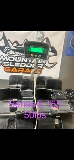

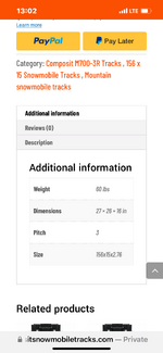

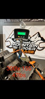

Anyone happen to know the weight difference between the 300LX and the M700? Just for curiosity sake.
madmax
4,496
3,151
Salt lake city
From the composit website the 155x15 M700 is 60lbs. Don’t have pic of when I weighed mine. My 300lx 155x15 was 47lbs. Just for comparison, my 3.25 155 was 50lbs.
I’ve had the M700 on my 850 na, light weight 9R and 24’ boost, it’s a really good 2.75 track, way better than the series 8. The 300lx and series 9 are better in deep snow, but if you want a 2.75 track it’s really good.
