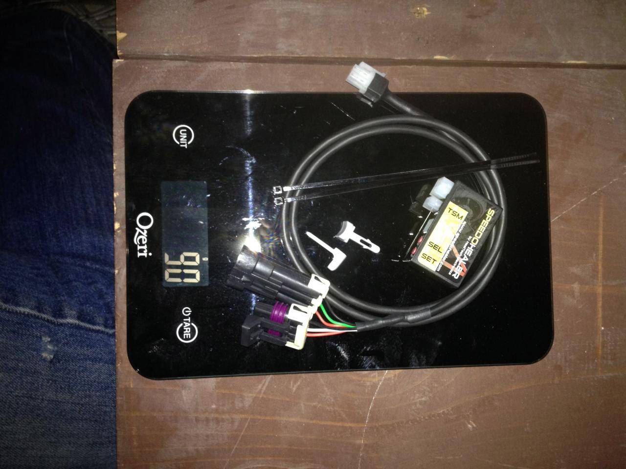

Final Install weight is 90 Grams or 0.198#'s.
The Speedo Healer Plug and Play Harnesses have arrived!
The first batch of Plug and play harnesses have arrived. More inventory is arriving daily. PM me to reserve yours. Thanks!
