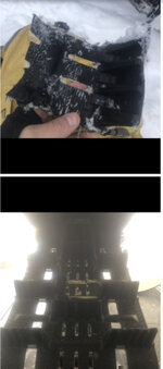

Don’t run high speed trail with that slotted track porting.
Or skidoo tracks in general.
Saw way too much of this over the last few years.
Delaminate and lose center lugs.
