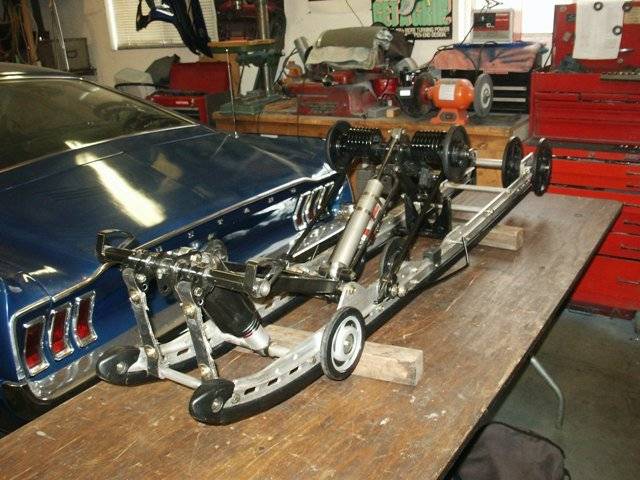

I know this is an older thread... I put the heaviest spring on my 166 track. By the time I am geared up and carrying a pair of skiis and a jerry can of gas I'm a fatty !!!
What an awesome difference. When it sits there it looks like it's on steroids !! still handles great, I just need to figure out how to keep it running !!!!

I am new to slowest and the forum world and I know this thread is old but I am hoping I can get some help on this. In may I picked up a really nice all original 2006 switchback 600 HO with only 1800 miles. It had the perpetual sagging issues that I have read about so on the advice of this forum i upgraded the torsion springs to .375/47* and the 220 lb front shock spring. Now that it is back together I have the proper 5 inches of sit in on the middle spring tension but I noticed when I was not on the machine and it is sitting on the floor the rails seem to be lifted at the front. They sit down to what I would call the normal flat position once I am on the machine. Is this just a function of the more tension on the new springs extending the rear of the suspension out further or is something a miss???????
The factory rails are tipped in the front so this is normal and stock, it was like that before u did anything ;)
