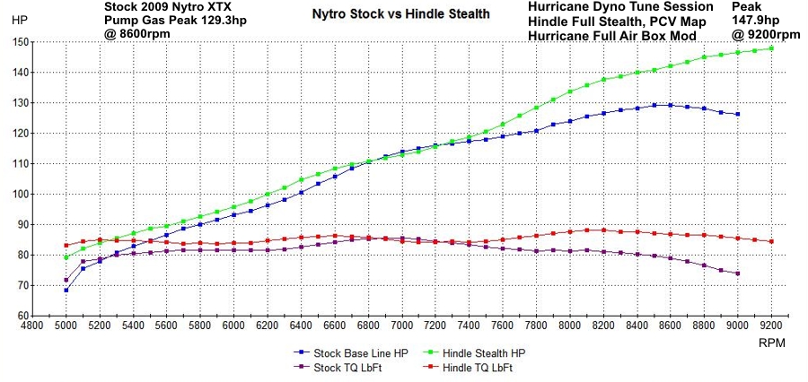

The Dynotech session was done on my sled...it made 9hp with no other mods, just stock mapping. That dyno session was a bust as Jim did not put a PC to see if he could get anymore out of it. However, the Hindle system does require airbox mods to make big gains. I'm on my 3rd season with it and absolutly love it.
I have posted a dyno graph in another thread, of the Hurricane Performance kit that uses a full Hindle system. This kit was developed on my sled and with a noise reducer in made 14.6hp over stock. Another fellow had his sled in there a week later and his made 18.6hp without a noise reducer.
The kit consistes of the full Hindle exhaust with a 20" muffler, airbox mod and PC mapped for the mods.
This kit will NOT dissapoint anyone who runs it...there are plenty of guys on TY running it and are very pleased with the gains. You will not get 35hp, nor would you from any kit with just bolt ons..but 15-19hp are the norm with this kit, just depends on whether or not you need to worry about noise...not bad for $1400
http://www.ty4stroke.com/download.php?id=69957
