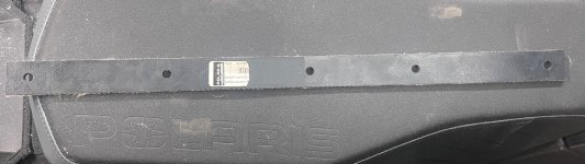

I understand what you mean about the rails. What I mean is that with the pro rails and the OEM Khaos limiter strap, the limiter strap is tight just sitting on the ground. More of a geometry thing then rail tip up / angle of attack.
I think with the Khaos rails the limiter strap is less taught. I had the shock on the skid after swapping in the takeoff Khaos shocks before I installed the limiter strap. I was worried about the shock topping out. I made a measurement from the top suspension mount point to the rail at a fixed point.
After I installed the OEM limiter strap the same measurement was over 1/2” shorter. So I feel the combo of OEM Khaos shocks and Limiter strap with Pro rails won’t give you the full extension of the Khaos shock. I think an aftermarket/ longer limiter strap is what is required to give the full effect without having Khaos rails.

Like I said in my post above. I think the combo with factory Khaos shocks and limiter strap with Pro RMK rails doesn’t give full shock extension. A longer limiter strap is required.
Just drill a new hole in your limiter strap where you think it should be to add the extra length. I have no idea why guys buy new when they have a perfectly good strap. I have done this many times over the years.
