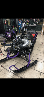

This is my buddies they just did I will be picking it up hopefully this weekend when I drop mine off I can get more pics when I get it. He rode that sled all last year on silbers recommended set up so as soon as we get some snow I can give you some real feed back. They installed an elevate kit ,bov with boost controller and their custom clutching I believe it’s about a $1000 upgrade over the stock kit time will tell I guess. I’m doing the same set up on a 2020 Mountain cat I hope it holds up to the hype...8C805253-E6F7-4617-A817-574CE958DCD7.jpeg
