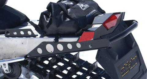

Well I had the chance to use the jack and found one problem right away. When I went to jack the sled up the rear bumper started to bend! I've got a 2010 Ski Doo Everest XP. Now I'm looking at trying to get a stronger rear bumper.
May I suggest...
Put one of these on my Nytro and LOVE IT!!
http://www.skinzprotectivegear.com/snowmobileproductah/bumpers.html

That does look like a strong bumper. Used the hi jacker the last time out, bent bumper or not, didn't bend the bumper anymore but it sure did pull it out of the hole! The guys with me definitely were impressed since we didn't have to pull out our backs to get the track up out of the hole.
