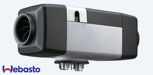

Is there a diesel parking heater that isn’t “chinah garbage”?
We run the Chinese ones in a work trailer. 24/7 all winter to keep product warm. They last about a season. if I wasn’t sleeping in the trailer I’d have no problem running one. I got one for my sled trailer but haven’t installed it yet.
