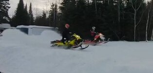

First I got James to slowly drive his sled around the track back and forth and then go into the crosser section in the back and giver a bit over the bumps. Then take Corey's xPert and follow the same course.
James was shocked at the engagement speed and how Corey's pulled off the bottom end.
Next test. Lets drive side by side up and down the race track and switch sleds each round and do this 4x because i want him to get the feel at part throttle speeds of both sleds. Then after James taking his for a rip again, then Corey's for a rip, he said "Make mine like Corey's"
DRAG TIME - Notice how I pulled up to James on the start, then hit reverse and I give him 1 full length start. My ski tips to his rear bumper. He's asking me "you sure about this" I said "im going to eat your lunch by the 200 foot mark". We did 4 races switching lanes, and he could pick the best line and give me the worst line, I wanted James to make the rules and give me 1 disadvantage. By 70 feet I reeled him in and going by at 100 and by 200 foot cone, the xPert made at least a 1 sled GAP between it and the turbo. And that's not my words, I was not looking back. I dont know how far I was ahead. That's James saying "at least a sled length gap between us"

Now James turbo sled can take me by a hood length to 3/4 length to the 100 ft mark and by 200 feet, he's gapped me 1 sled gap. Holy cow does that turbo sled rip now. HAHA.
