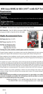

I started with 1 gal of av gas to 4 of non eth premium. Trying a little less now on advice of SLP, like 1/2 GAL to 4 1/2 non eth. These pipes are THIN, not a fan of header wrap because EVERYTIME i have wrapped headers they crack and I ended up chasing cracks.
Obile are you sure that these pipes are ceramic coated? Looks like paint to me.

Screenshot of the install instructions from slp.im thinking that it is black ceramic coat. Seems to be a little more durable than header paint.i think if it was paint i would see some rust starting .

When I think of ceramic coating on pipes I am always thinking of heat barrier coatings. I use a lot of Cerokote in my business and its very durable but I have never heard of it being a heat barrier.
