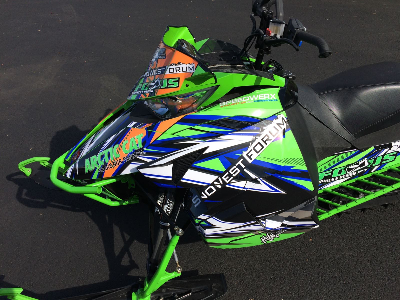

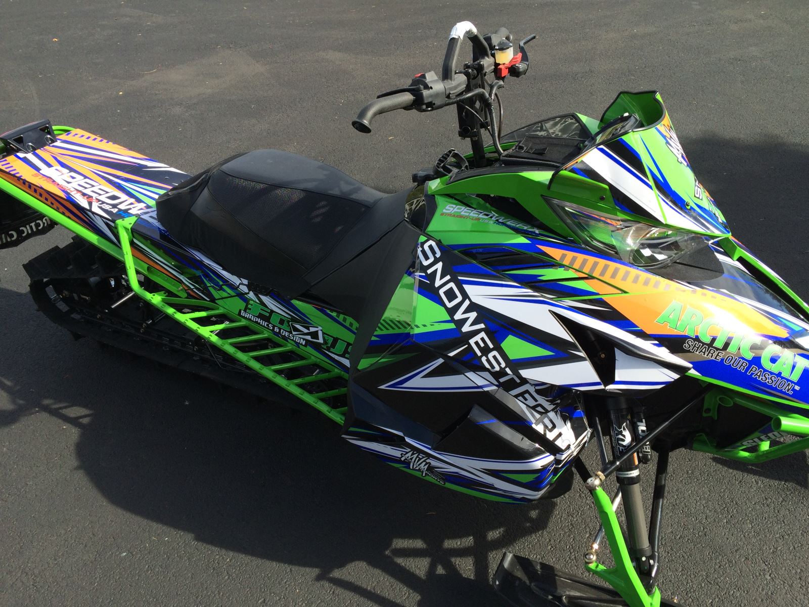

After four months of preparation, installation and explanation, the SnoWest Forums project sled is finally ready to be given away. And as you can tell by the photos, this is one sled that would look great under you.
The final build involved putting on a custom wrap from Fokus Graphics and Design. Jason Mora designed a wrap that would give the Forum sled a unique look. We then turned to Cordell Barnard of Mountain Maniacs ]208-681-4810

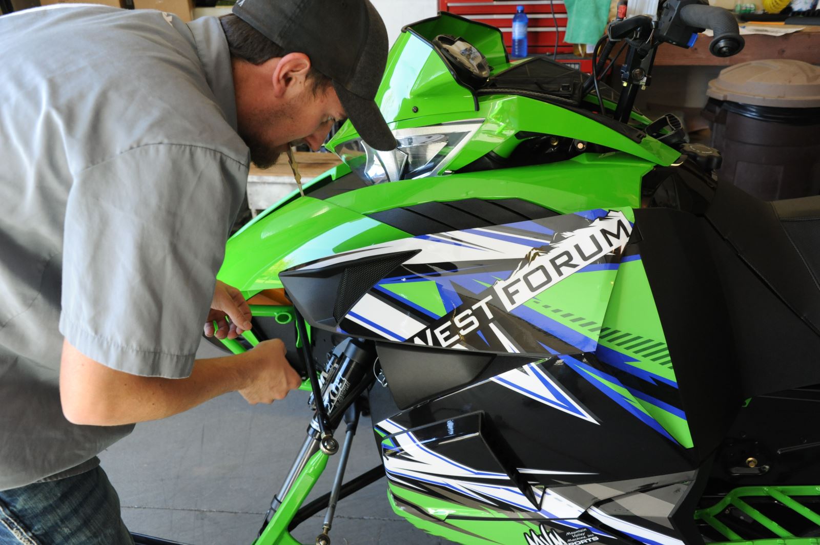

Wrap installation can be somewhat overwhelming. There are a lot of pieces and they tend to want to stick where you don’t want them to. It’s nice to have an expert who understands the process and knows the tricks in making sure it runs smoothly.

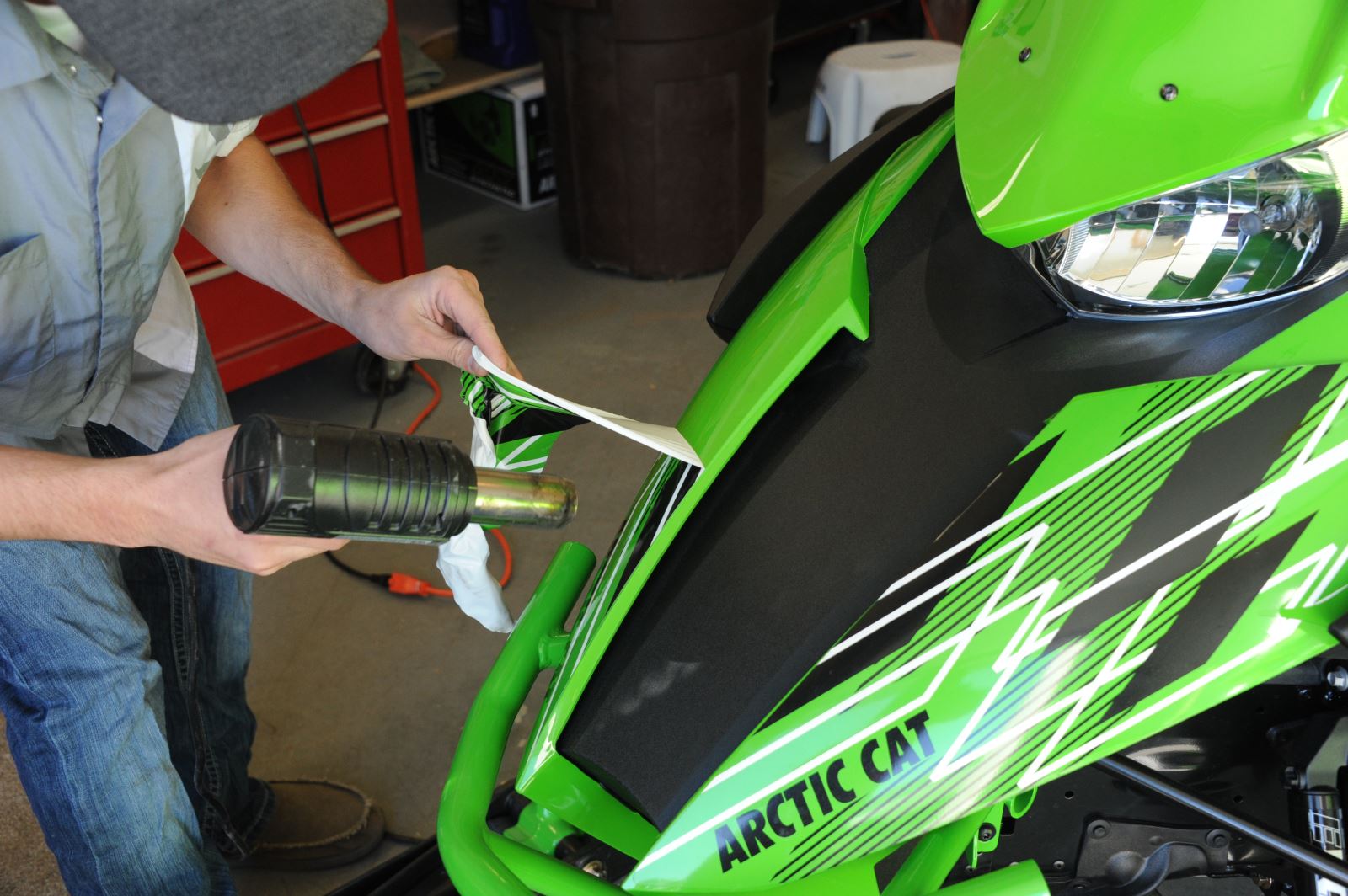

1) If your wrap is going to cover any VIN stickers, you want to take a photo of those VIN stickers so you have the information in case you have warranty work that needs to be done.

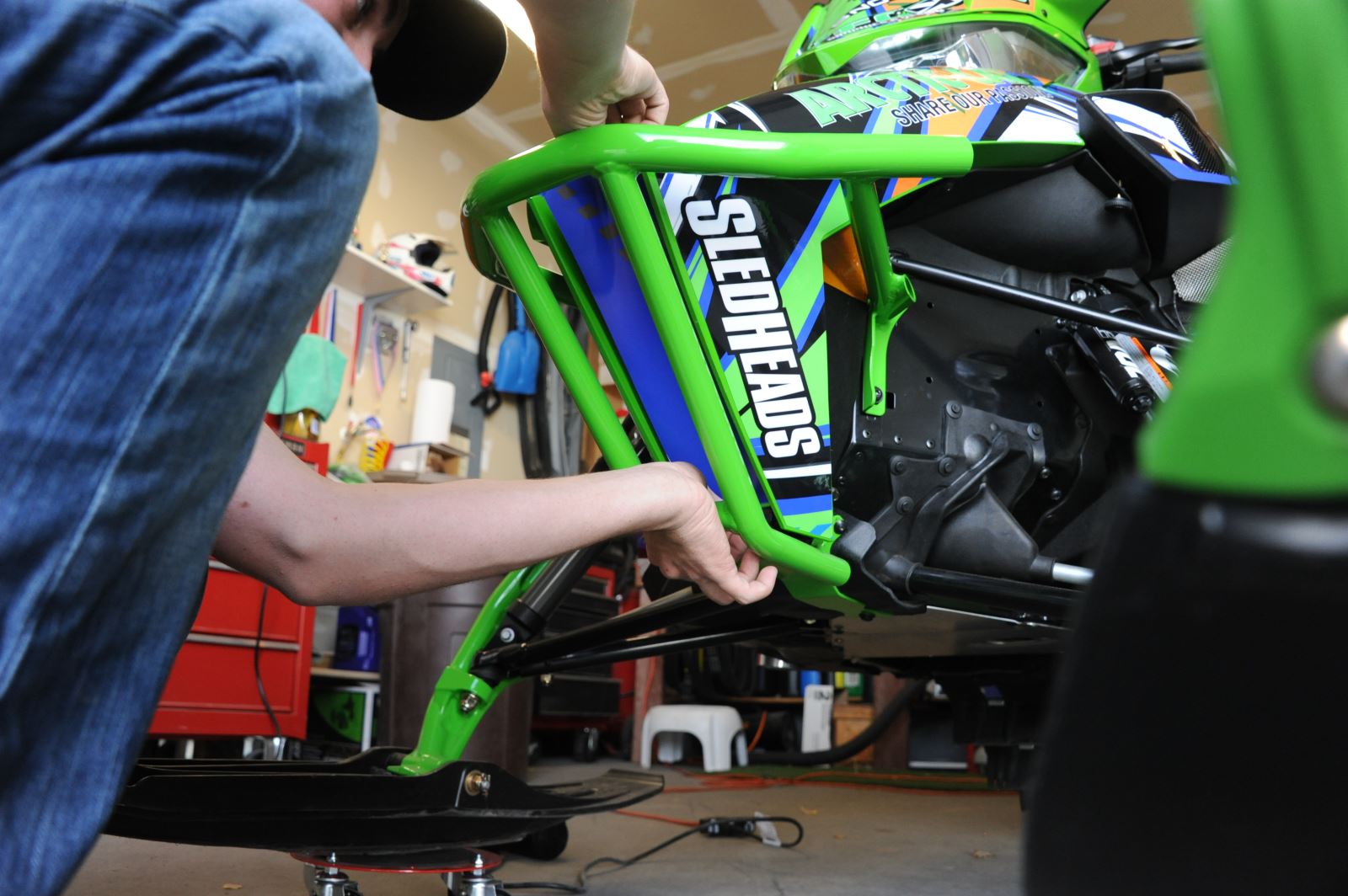

Remove stock decals. Although some people may be tempted to install the wrap over existing decals, Barnard says it’s best to remove the old ones first so you don’t get bumps and ridges in your wrap. 3) Clean the area you plan to cover with the wrap. It

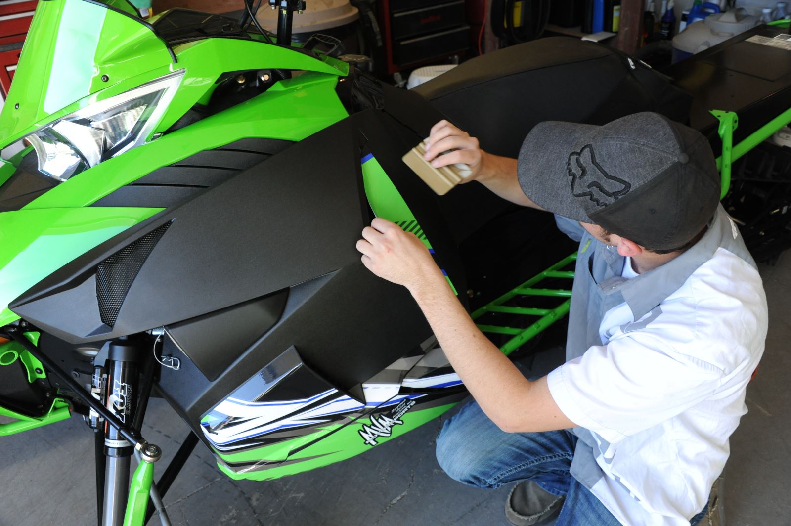

Depending on how the wrap lays out, start and work your way methodically over your sled. Some like to start on the front and work back. Others start in the middle of the hood and work out. It doesn’t matter … but it’s best to not skip around where you
Once all your decals are attached, go back and do whatever trimming is necessary. Not all decals will fit perfectly so some tweaking is likely required. Also, even though the wrap is designed to cover most of the sled, you may choose not to use some pa
Once you’re confident you have everything exactly where you want it, then you can either apply a little heat to the decals or you can put your sled out in the sunlight and let nature bake the decals on to the sled. This process allows the decals to fix
