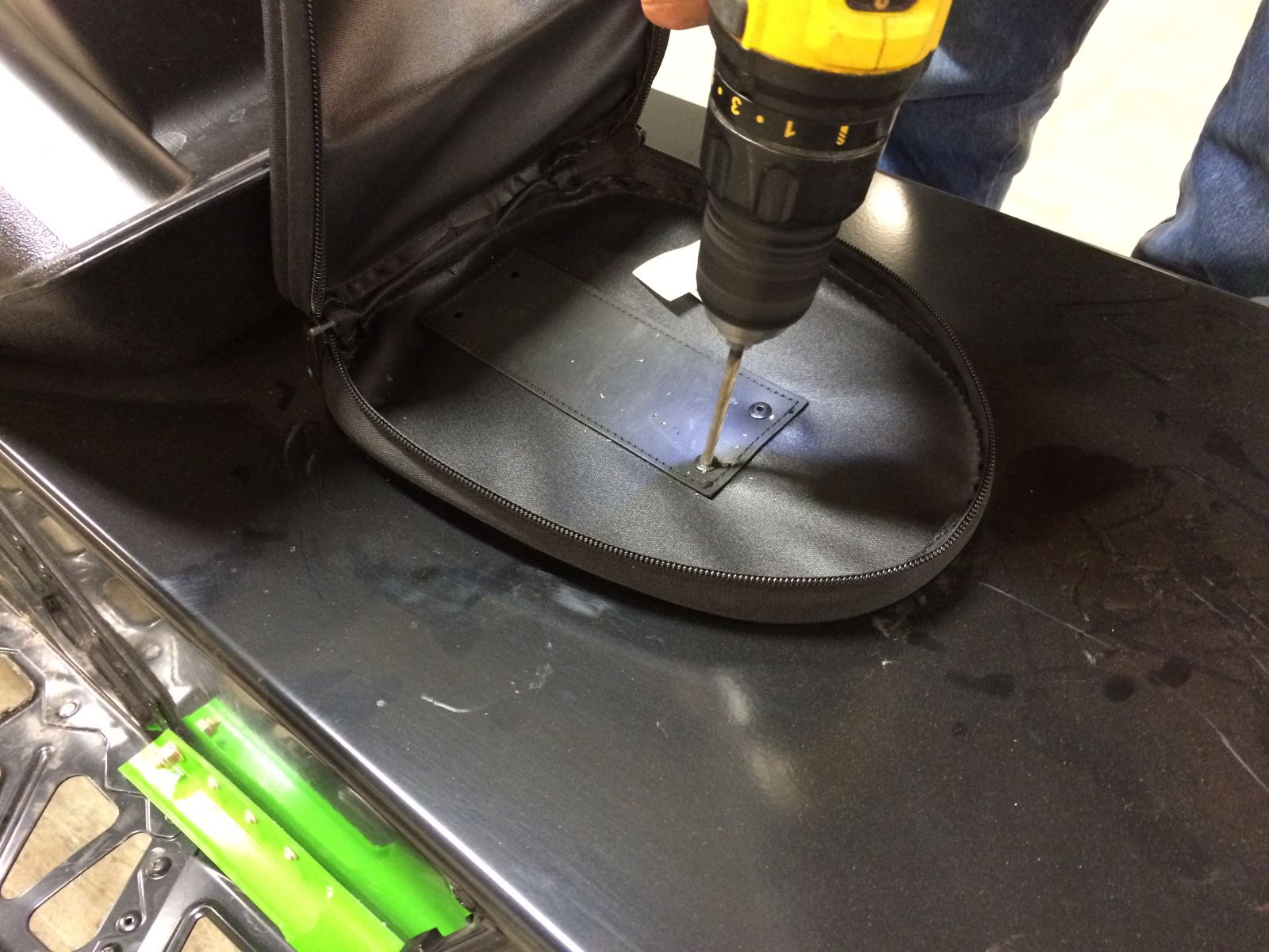

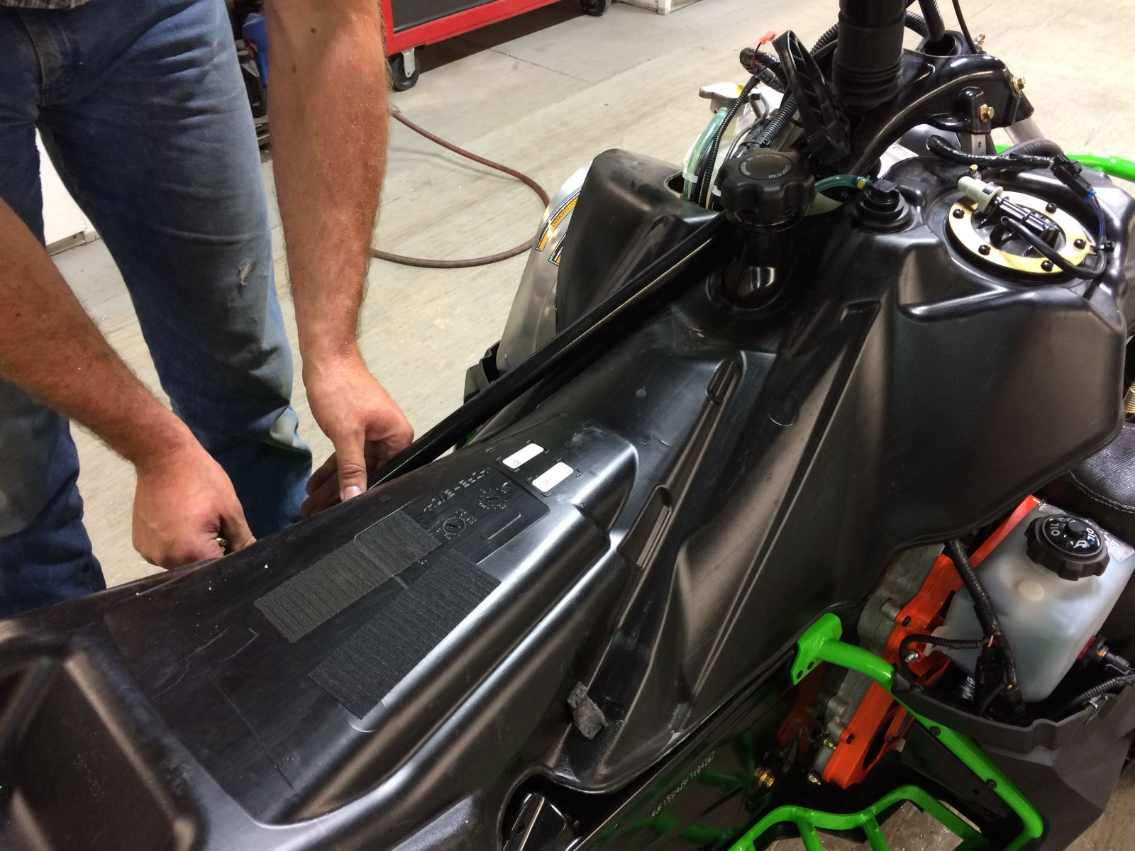

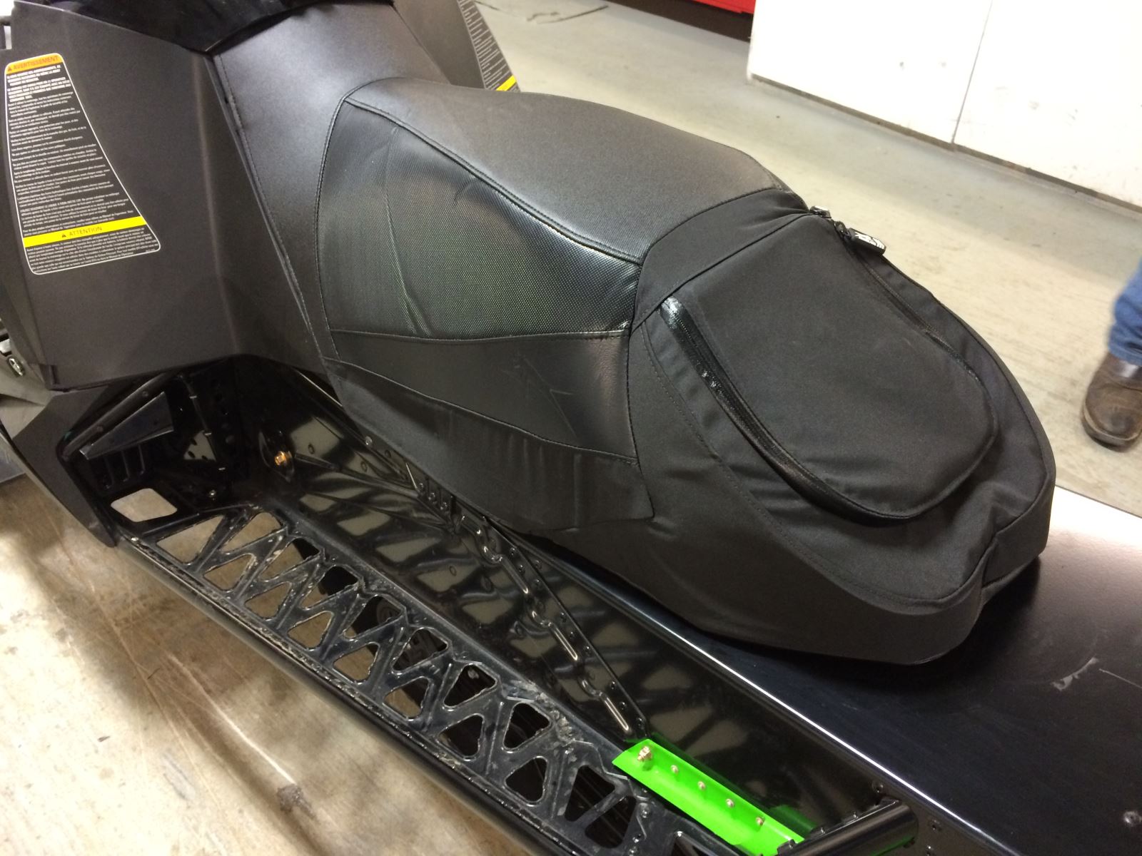

Seat Removal 1) Remove two screws on the seat bat wings, one from each side of the belly pan that attaches above the foot rest. 2) Remove two screws that hold the seat to the tunnel (one on each side). 3) Pull seat straight back and remove. 4) Remove the

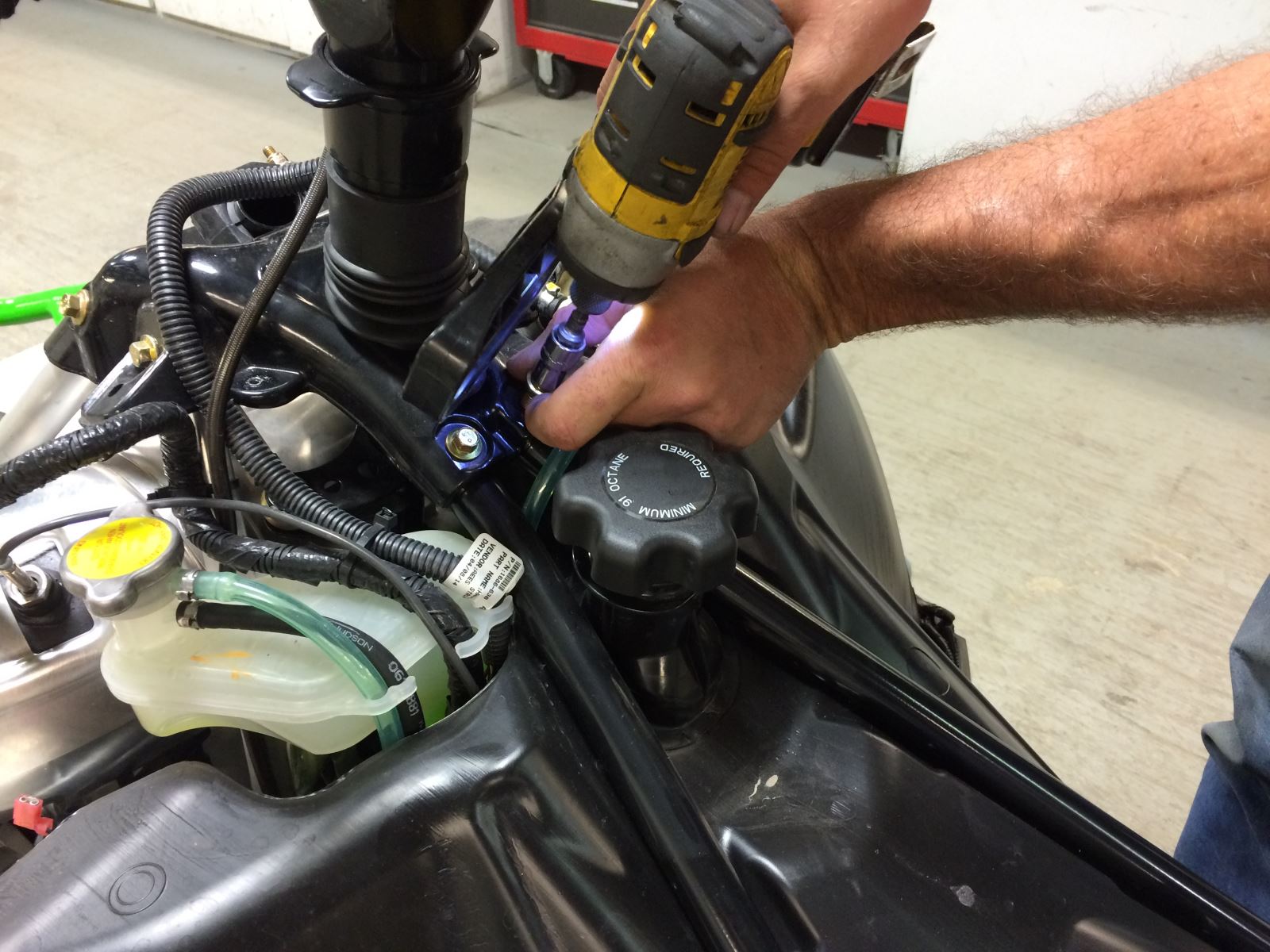

Gas Tank Removal 1) Remove two screws on the console and remove gas cap and lock. 2) Unplug reverse beeper wire on the left side under console.
3) Remove fuel tank spar bars (held by two 10 mm bolts) 4) Remove fuel line to allow tank to be slid back out of the way to expose bolts that hold foot rests.

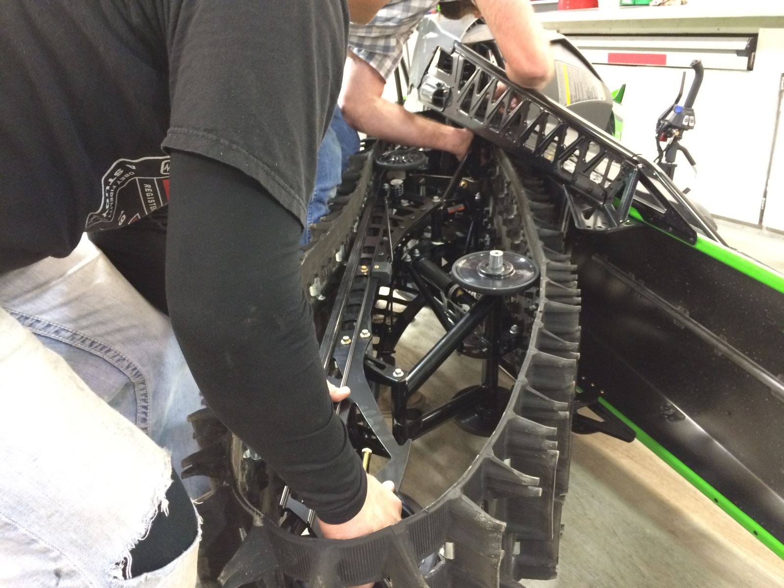

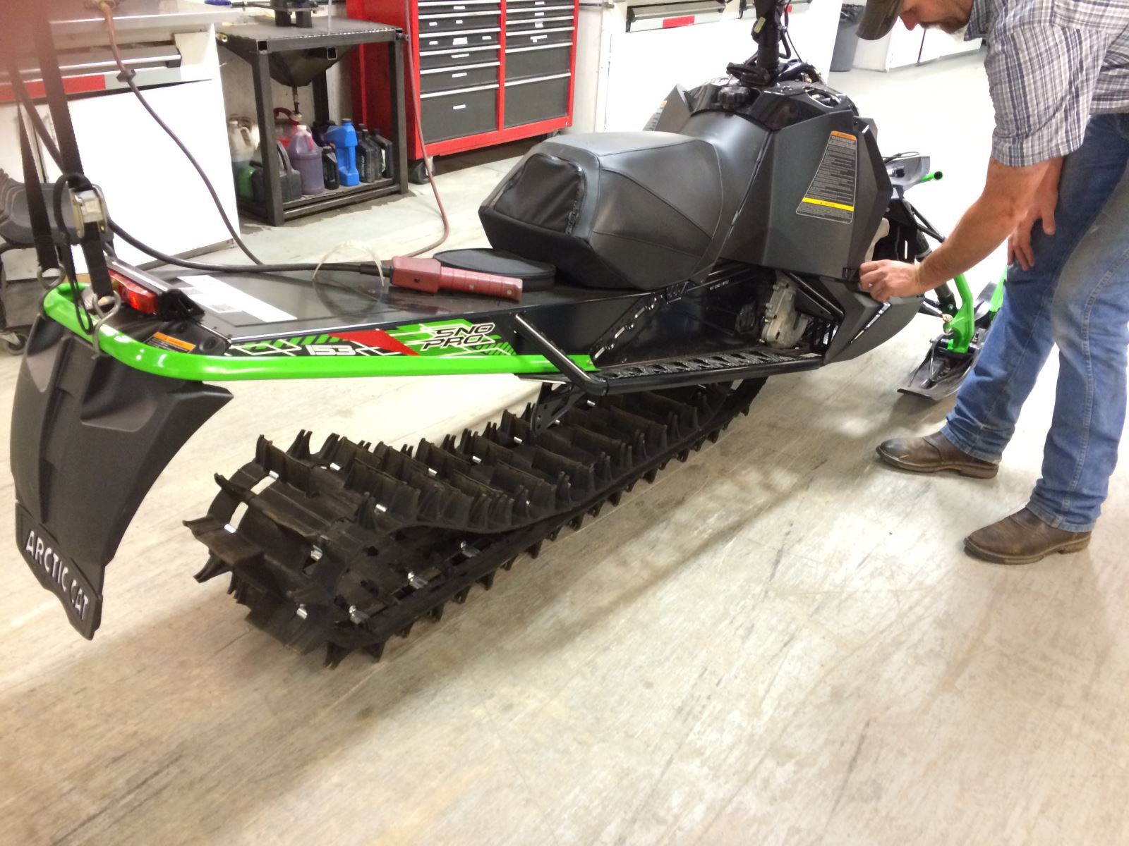

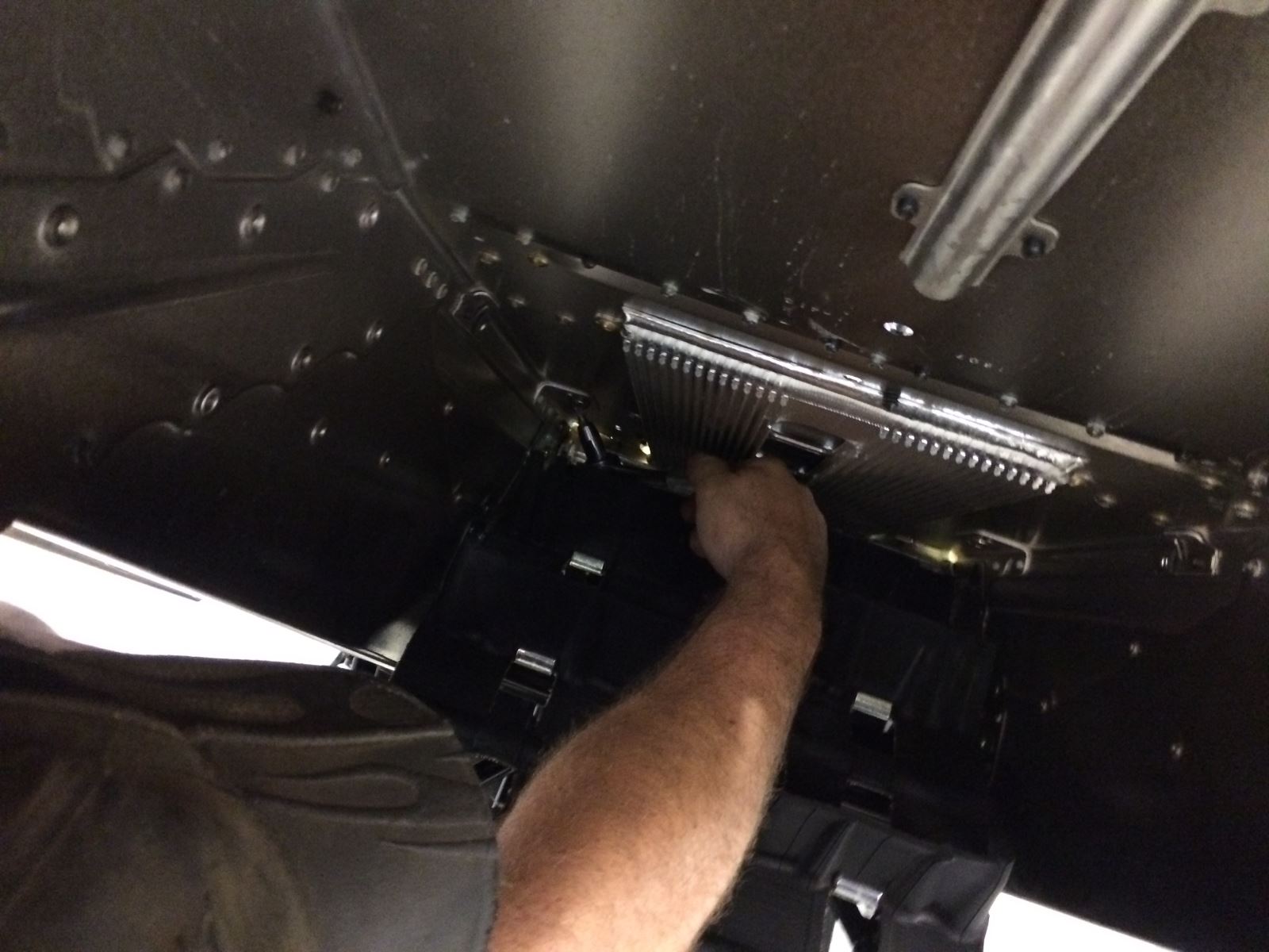

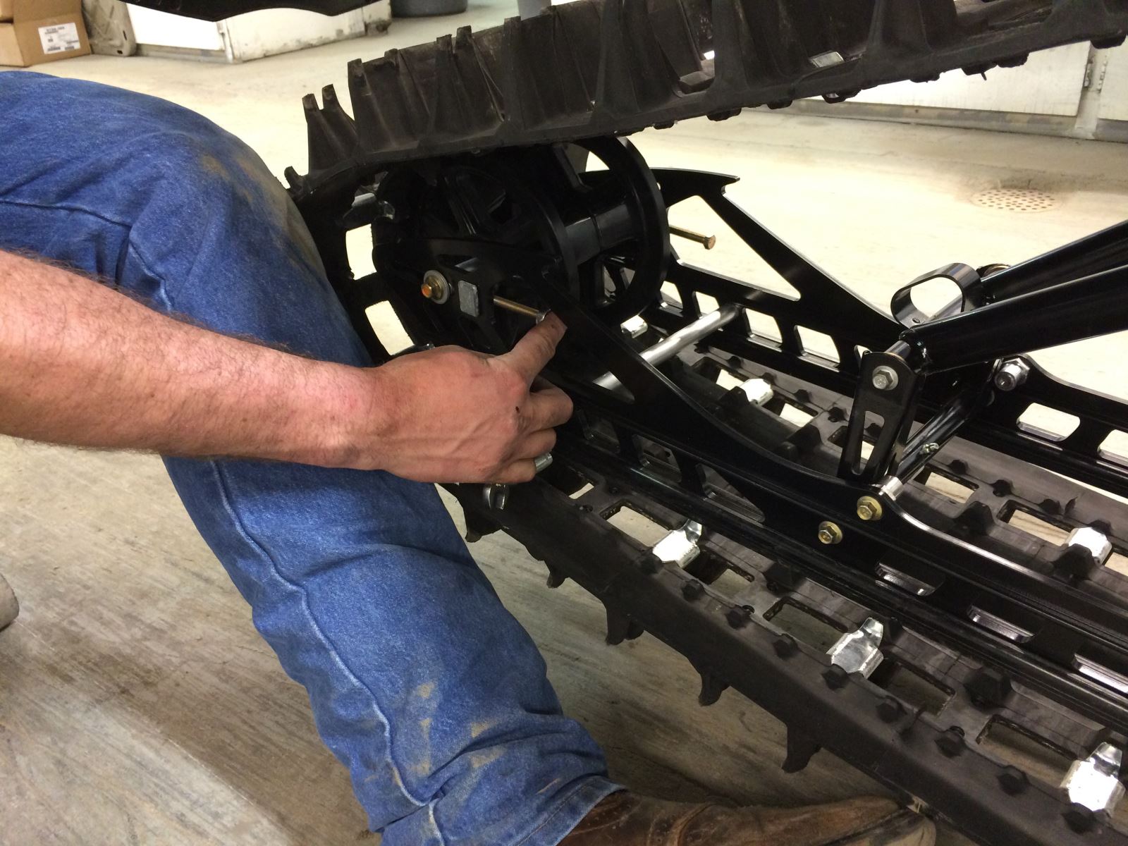

Skid Removal 1) Elevate rear of sled to remove tension from rear suspension.
2) Remove rear skid. This involved talking out four bolts and then wiggling the skid out from the track.

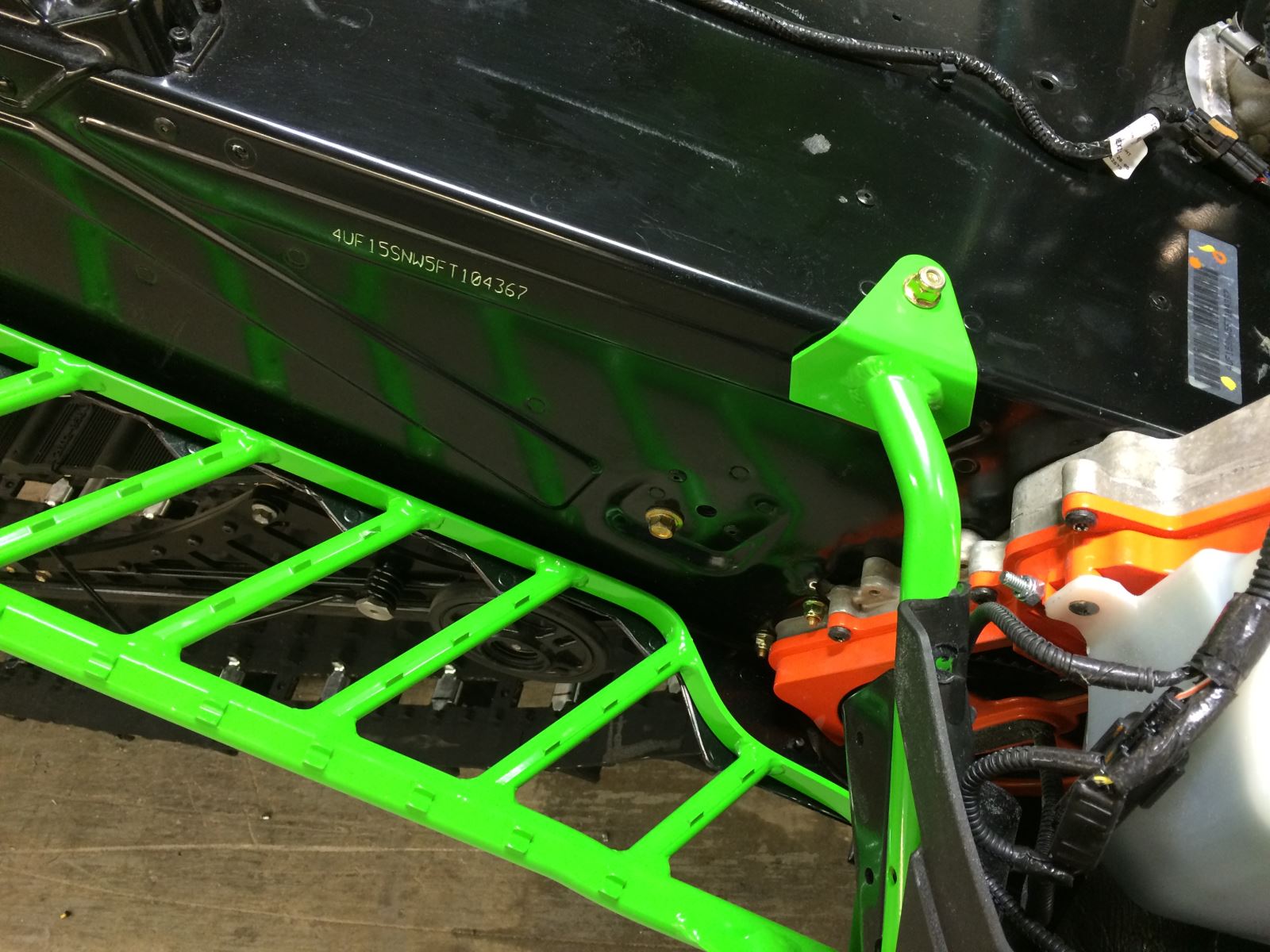

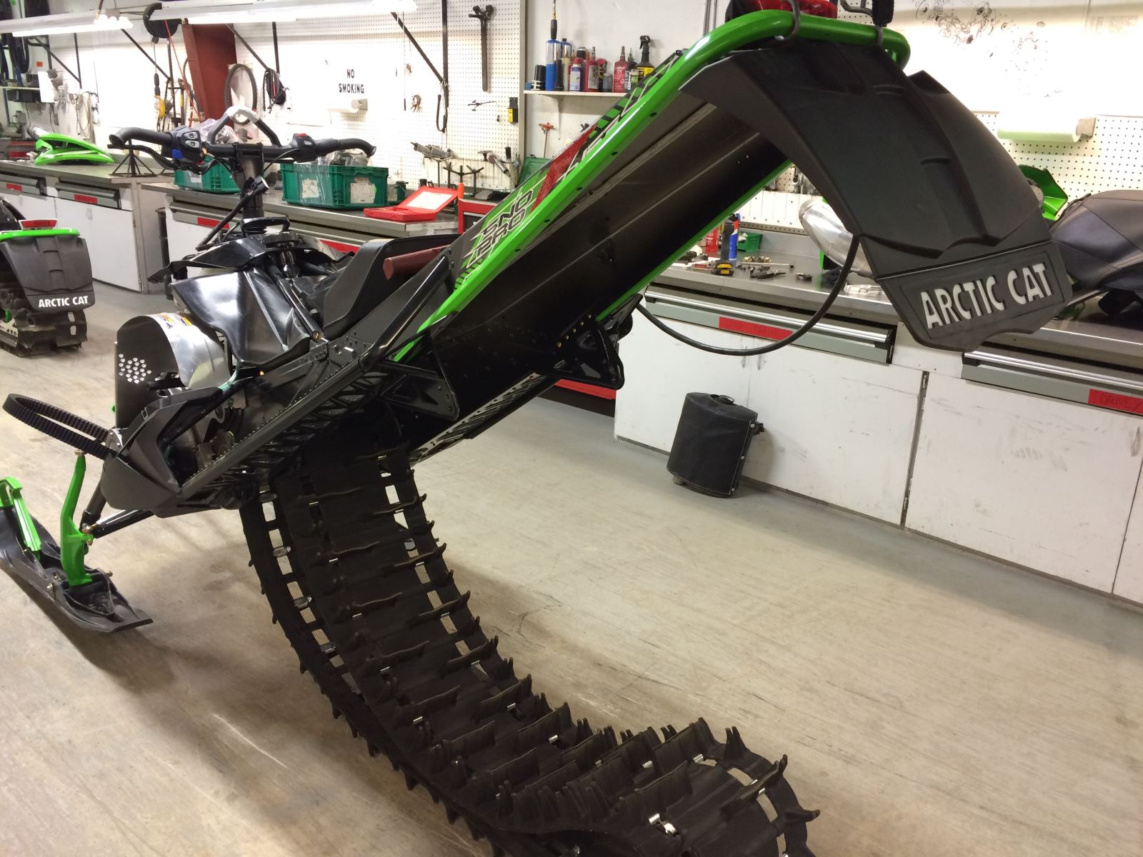

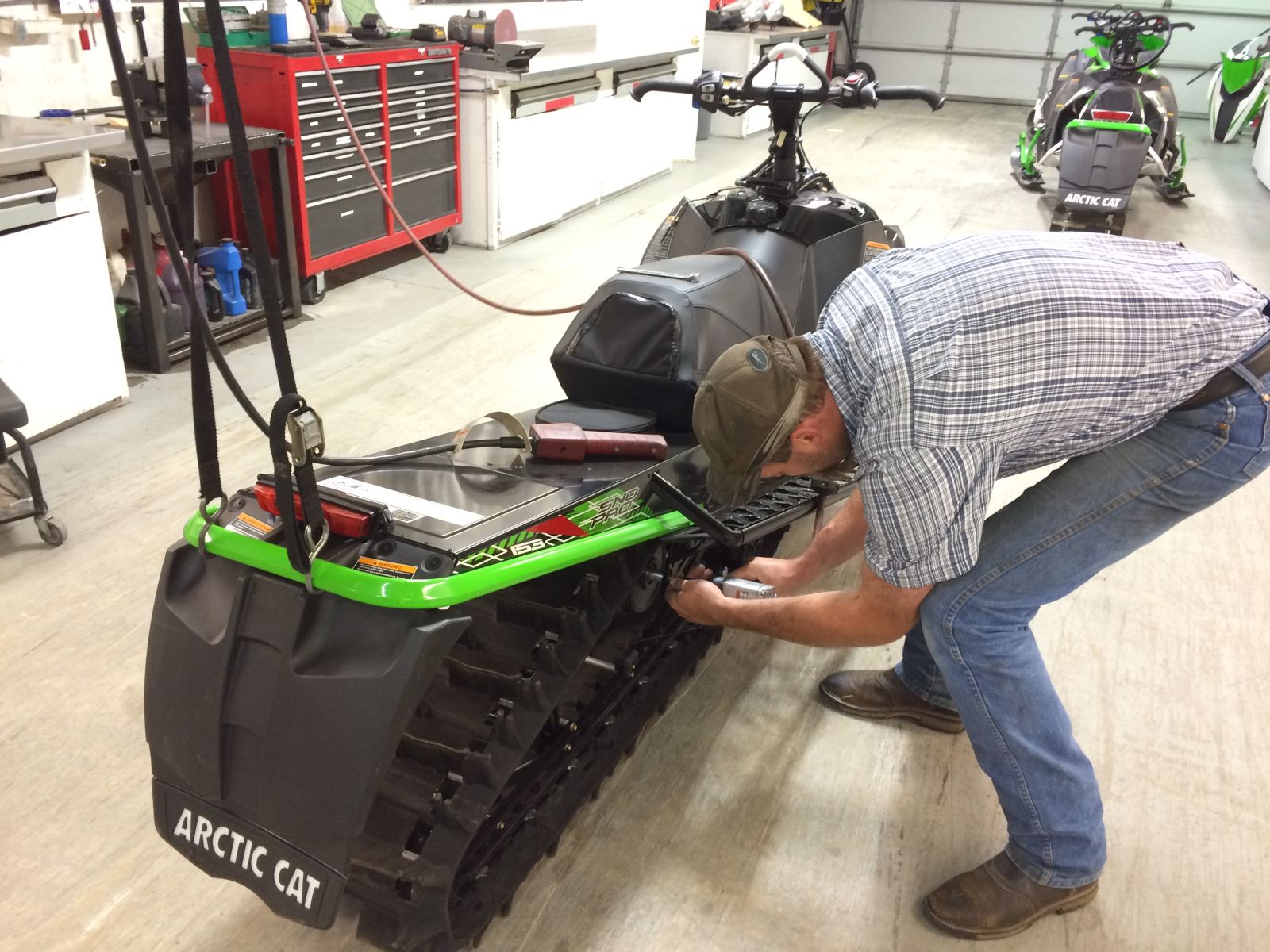

Running Board Removal 1) Elevate rear to allow access to foot rest bar bolt.

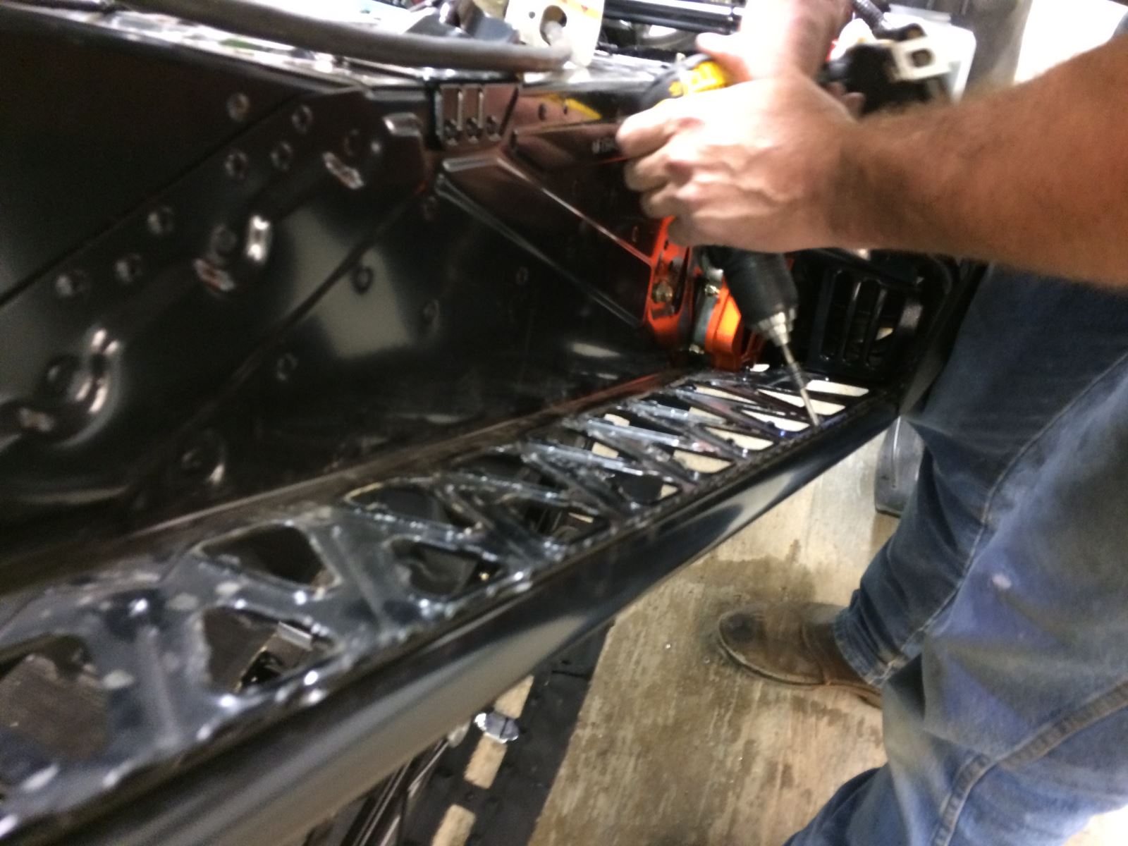

2) Drill out (remove) rivets on the rear of running board foot rear mount and front foot rest bar. 3) Unscrew belly pan attached at foot rest (three screws per side).

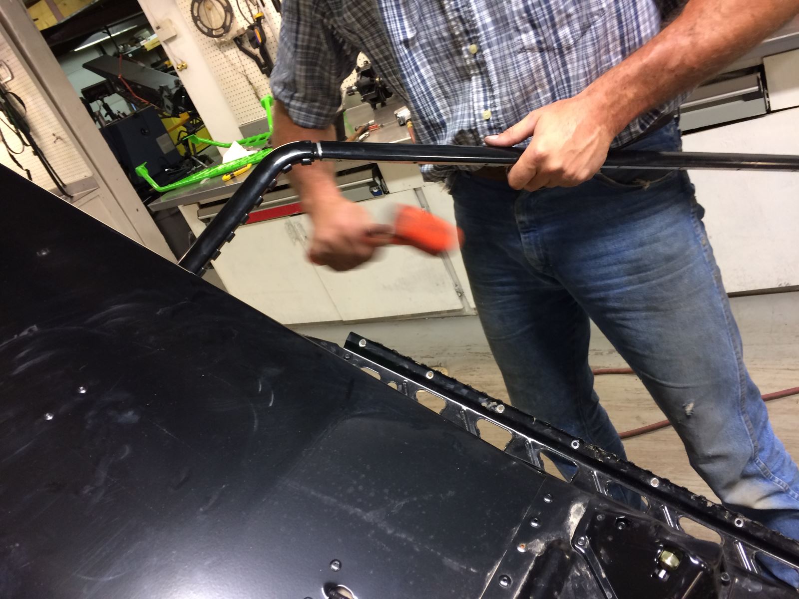

4) Separate running board from foot rest bars—both front and rear.

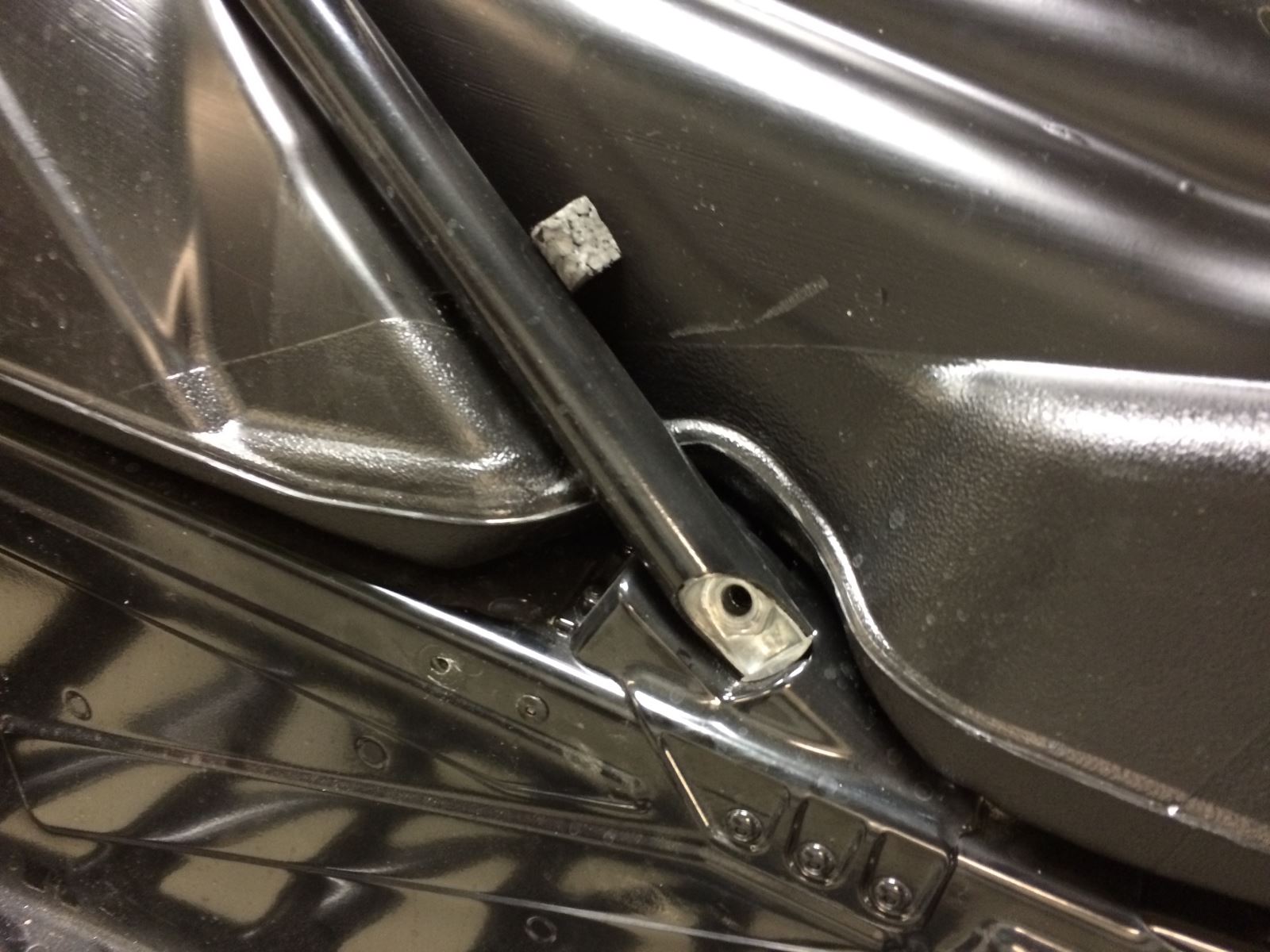

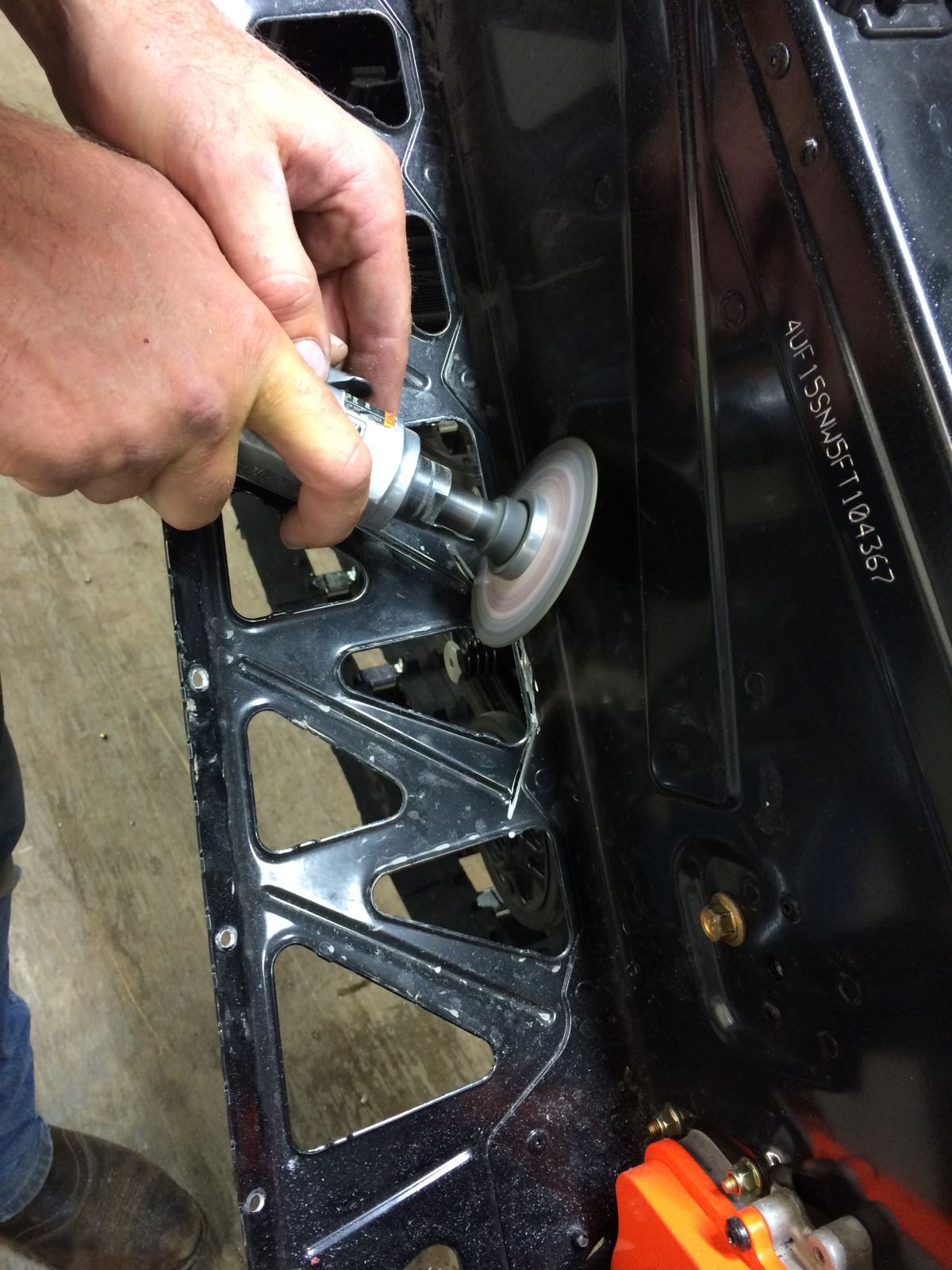

5) Drill out all rivets running the length of the running board support. Also drill three back rivets that attach running board to bumper. 6) Remove support bars on both sides. 7) Drill two rivets on each side that hold front of running board to the belly
9) Make cuts, remove running boards and sand edges to clean up area.

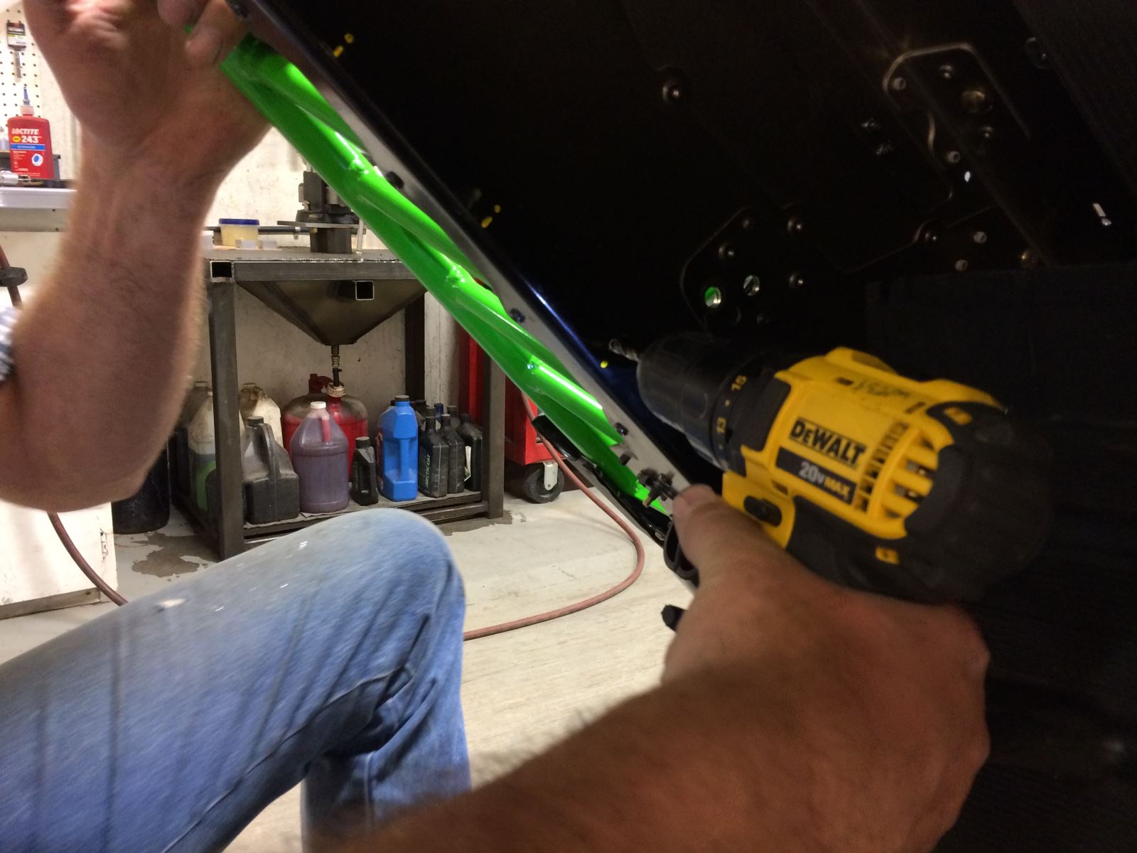

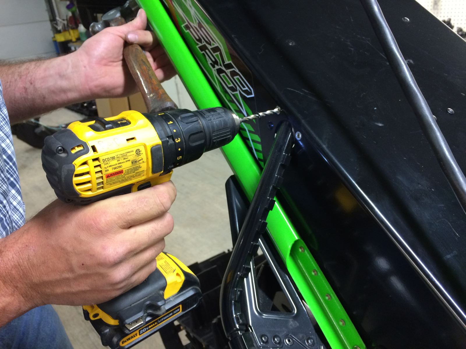

1) Place new boards on sled. Bolt then into position to secure them in place.
2) Drill holds and attach rivets. (The holes are designed to go into the cross bars of the new boards for a clean assembly. It is a complicated process that involves spacers of various lengths. Be sure to follow Cat instructions … which are actually prett
