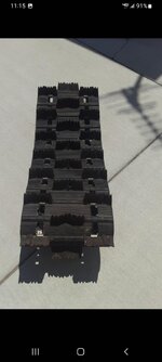

Don't know the answer but I have an immaculate 153 track that came off an 08 M8 after one season. Camo Challenger. No tears or missing lugs, been stored indoors. $250
