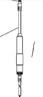

The 3 850’s I checked this week were not getting full throttle.
It’s easy to check, this is not done with your engine running?.
Hold your flipper to the bar, then push the cable toward the bar, if you hear it hit the throttle stop you need to adjust your throttle. Adjust it until you hear it hit when depressing the flipper. Don’t go to far or your TSS will take over. Yesterday’s needed 2 turns on the slack adjuster.

Yeah, the finger throttles have to be fully maxed out on the adjustment threads. It's a bummer Munster doesn't use an adjuster barrel.

Just checked my 2020 khaos and I can depress throttle wire almost to the bar till I hear a clank of full opened. Tried to see how to adjust, but tough to see. Do I need to pull can for access or better remove air box?

couple of 20's all were on the loose end of spec for sure, picked up easily 5-10% throttle opening. Few extra ponies and these '20's sure are ripping.

Mine seems to go tight when I turn it all the way to the left. Had it stick on me a little bit yesterday like this. I thought my freeplay was a little too tight but when I checked it was actually looser than the spec. But now when I turn it to the left, there is no more slack left at all.

If it’s a finger throttle, that’s how they work.
The guys here have taken them off because it’s a safety issue.
