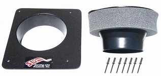

Are you talking about this one?

Yes, the one pictured above is the one I was referring to when I chimed in on the topic.

I will be running it on my 07 M8. And i am reffereing just to the little horn that comes from the intake box and goes into the air box. Not the whole intake box. I will try and find a picture.
This is what i am talking about, not the whole intake box. Sorry for the confusion i should have been more clear.

p.s. i also don't see how the slp air horn deal will help prevent clogging. does it not use the factory intake vents by the windshield?
that one uses the stock intake as well as pulls more hot air from under the hood. I was against the drilling holes but after a few deep snow bogs I installed a bdx intake and I'm sure it made more power, felt like i dropped 2,000ft in elevation, but my fuel setup is a lot different then every other. I ran a m7 stile intake cone on a 07 m1000 and it worked well. on a stock sled I would keep it as stock as possible though.
