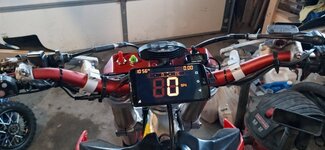

Do you have your phone mount powered? Can you give specifics or pictures of your setup?
So when I did this I went as cheap as possible because I didn't know if it would work. Instead of buying a waterproof case I sealed up all the ports on the phone itself. This one only has buttons in one spot on the back so it was pretty easy. To mount it I used a small piece of aluminum and attached that to the handlebars then used adhesive velcro to stick the phone to the aluminum. It's solid enough and I can take the phone off if needed. I might make something nicer next summer.
I bought a 12v to 5v converter and wired that to the bike.
Last thing, I installed an Automate app so when it sees or loses power it will launch or kill my apps and dim or turn on the screen. With this I can also keep the gps going while the bike is off so it's not always looking for sat signal.
