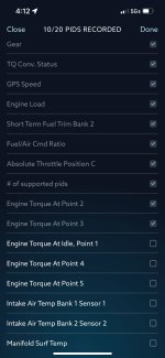

Waiting to hear back from support but I’ll ask here too:
New AA3, latest firmware, 2025 Summit 850 N/A. Connects fine when engine running, shows a variety of parameters, temps, GPS speed, engine torque and about a dozen other things but no RPM anywhere that I can see in the list of PIDs that you can add to the dashboard. On their website when you put in a Skidoo 850 as vehicle type it does show engine RPM as one of the available parameters. I was hoping to use this as a data logger to help with clutch tuning.
What am I missing?
