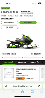

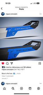

Anxious for my25 and am looking forward to start the build this fall! What’s on your (mod) list next yr? I’d like:
Diamond S ti can, hoping they start building again for cats as last yr they did not for the ascender!
Hoping for rogue concepts to get there rear bumper to market but haven’t heard back from them yet, may end up going backwoods.
Leaning towards the backwoods front bumper, would like to see there new inserts they make for running boards in person first as they look to be not very aggressive for traction?
Cheetah boondocker 2.0 with 2” knucks is a must.
Having the 600 all yr just really has me so excited and pumped for this new 858, wet weight was 505lbs on the 6 so it’s going to be pretty easy to get sub 500 on the stroker.

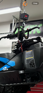

Man this sled is baddddddazzzzz,
G8
Elevate
1.25 riser with boondocker2.0
BMP bumper
517.5 lb full fuel,oil with spare belts!
Diamond S is preordered so may end up close to 500 rtr

Be careful if you are thinking about the backwoods rear bumper and you don't use the stock plastic running boards, I put the hardcore boards on mine and the backwoods rear bumper doesn't work with them. I really haven't found an aftermarket rear bumper that will work with the way cat mounts there hardcore boards other them the EVO rear that cat offers. I installed the backwoods front bumper and works well and I think it looks the best of all the options I've seen.
Thank you, I was interested in the weight savings of the hardcore boards but hearing this now has me thinking 🤔
