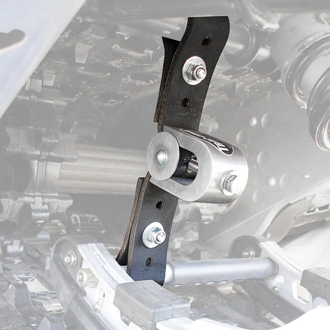

Build one for the Polaris- you could make hundreds!It would take some significant modification to put the doo adjustable limiter strap on the Polaris. More than the average guy could do.

The lower bolt hole option is gone and I don’t see enough room to replicate it.
Ordered. Never met a gadget I didn't likeScroll down a little.
The 2025 RMK PRO and RMK Khaos sleds are no longer equipped with the factory pre-punched lower front skid arm drop hole. We recommend the front arm drop for anyone running our taller ELEVATE spindles on an RMK to balance machine front to rear. This kit allows you do make this key geometry change on your 2025+ Polaris Matryx PRO or KHAOS. You may also run this with a stock front end. Ultimately this will make the machine lighter on the front end to compensate for a taller spindle or make a stock sled without front end changes more lively. This kit maintains the factory hole as well so you...

Khoas has a lower mounting location for the Front Track Shock. Pro has the indent for that hole on 23 and 24'In 2024 and newer with the rails being the same, if guys like you and me change our shocks to Fox, the Khaos/Pro are only different from the limiter strap length. Very easy changes to make.
Not sure what $$$ your willing to spend but I installed a full ice age suspension on my 850 Khaos 155 including the rails, 9 inch big wheels and elevate spindles and FTS dropped to the lower hile. I recently transfered this setup to my Khaos Boost 155. Along with the float qs3 I don't think I can ride anything else ever again. It's like the best of both worlds. Playful like a khaos but tamed a bit for technical riding as well.Would love a bit more ski lift and playfulness. I don’t need to go full khaos at this moment, but just curious if there are some adjustments on the pro suspension to have a little bit more ski lift and playfulness.? Do I start on the front or the rear shock? The limiter strap does not seem to have any adjustments.
