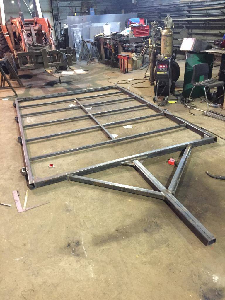

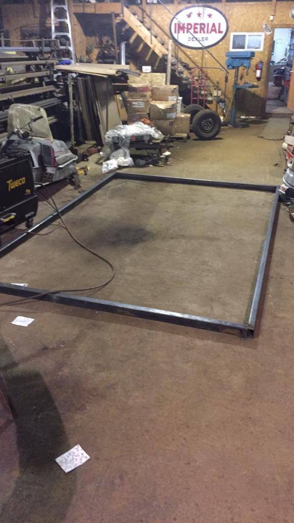

Started out with this 8x12 frame made out of 2x3 tubing

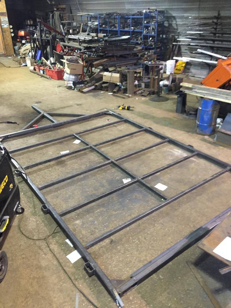

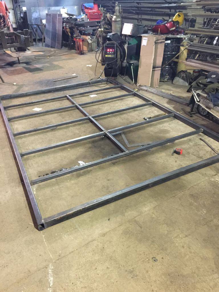

After that i threw in some 1 1/2 square tubing cross members which seemed a little to flimsy so put some more tubing down the middle.
Reinforced all the corners with 3/8 gussets and welded on a front hitch assembly.( yes i realize i should have put the hitch tubing farther length ways under the trailer) but hey its to late now. Put angle iron along the front and back also for the wood deck to mount to. This is how it sits now.

Might want to run something under the tongue back underneath and brace it in there a little. Give it a little more support all of the stress isnt torqueing on that front cross piece.

I agree that the tongue needs some more support.
I would think that after your spring perches are welded on you could run a diagonal from each side in front of the perches to the center of the trailer in the front to help stabilize the tongue.
It may look good now, but it would be a pity to snap that front piece after a couple years of rough roads.

And yes I will definitely be putting some sort of extra support for the front tongue

Hitch
Use the same square tubing that you used for the braces for your hitch, now follow that same line from behind your front crossmember to your outside rail. This will strengthen your corner and better distribute the pull.:face-icon-small-win
