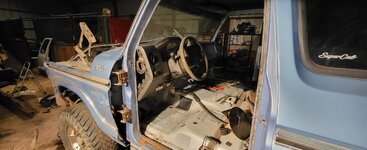

i would like to see more of this old ford project!!!!
I have a short YouTube video. Exnihilocustoms. It's set up with 2017 6.7 pedestal and turbo. Runs great!
