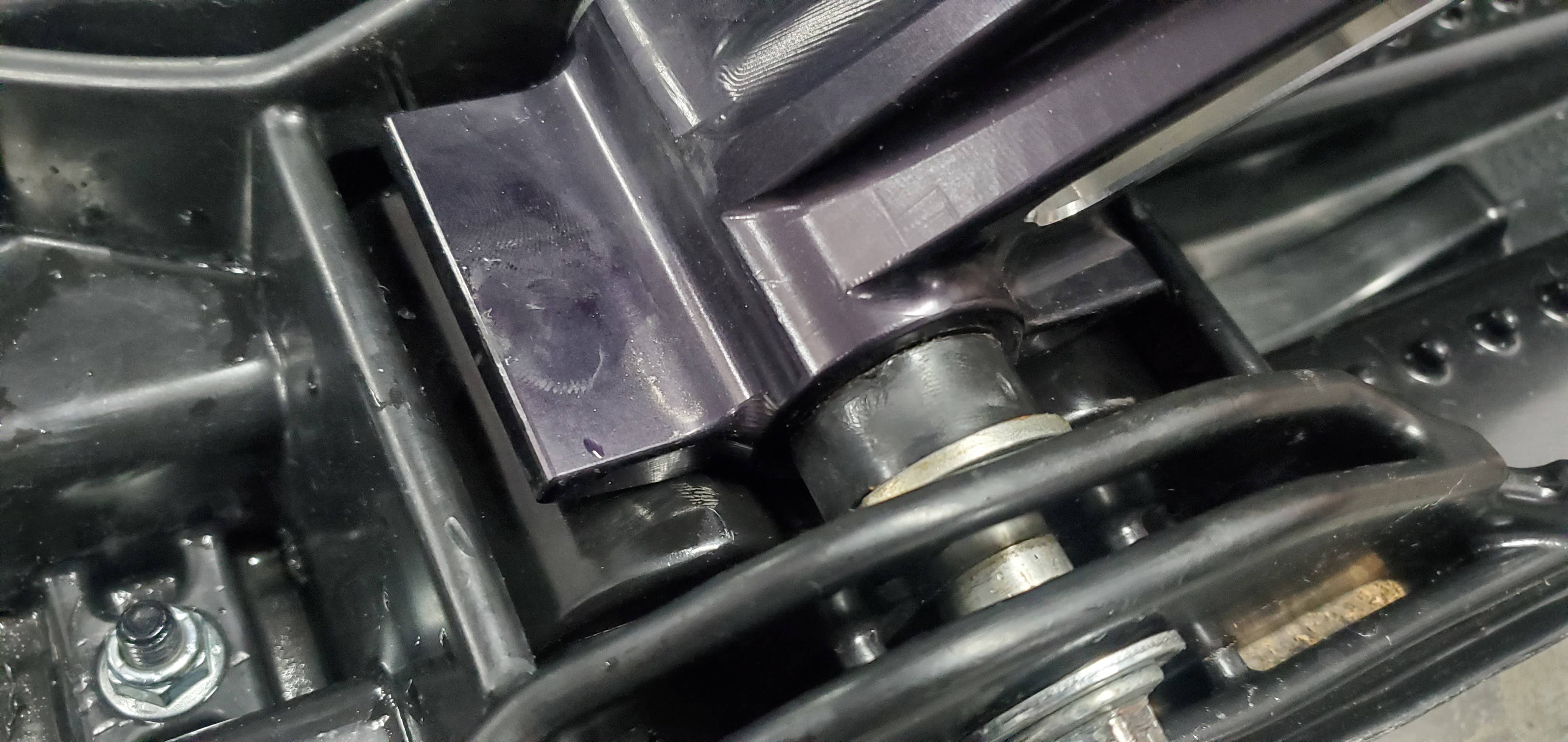

The 14/15 cat ski rubbers suck with the elevate when using gripper skis. Spindle sticks out too far and it's too aggressive at the tip, and just digs into the cat ski rubber. This cat rubber in the pic is the second ride on it. One deep pow dive and it is done. Luckily the dura pro gripper ski rubber is a perfect fit. And when running grippers on the cat there is no longer a need to trim the gripper ski saddles or nubs on the cat ski rubber. Its a direct fit, and the dura pros completely cover the ski saddle without the spindles stock or elevate being able to over reach the edge. Tight fit even with my ski saddles trimmed, but the dura pro has that area notched out already. The ski bolt will go through as long as you put a wedge under that spot on the inside of the ski, with the steering turned and locked out. And a hammer to get the bolt through...

Just went outside and checked mine.
Yep, same thing. 3 rides. Dammit.
Thanks for the heads up.
May just have to put the grippers on now. Got tired of dealing with the broke pads so haven’t even put them on the Alpha!
Are they only needed on the Elevate spindles? I don't see any issues on my Proclimb with 2016 spindles and Grippers.
Elevate spindles are more aggressive for sure, and beat up the cat rubber very quickly. But Id use them on stock spindles as well. I usually put a new set of cat ski rubbers on every season with the stock spindles.

I think that's what CO2.0 was stating in this thread, that the Polaris Dura-pro dampers fit the Gripper skis & the AC or IceAge spindles. I hope that I understood that correctly, as I ordered the Dura-pro Polaris dampers for my '17 AC Mountain Cat running the Gripper skis today??
The Polaris Durapro fits the grippers no matter which spindle you are using. Not sure if they would fit the Cat ski saddle or not without modification

Yes they fit, but fitment is TIGHT! Takes some work getting the bolt through. So I did take a couple really hard ski hits and ripped the elevate spindles straight through 2 durapro rubbers. The elevate spindles are too aggressive at the front tip. And combined with the durapro being stiff it rips them apart. But like I said these were 2 really hard ski hits. One hit ripped my entire suspension off and I rode back on one ski. I bought a kimpex rubber and want to try that as well. The durapros will work better if you dont already have grinded down ski saddles on your cat. But with stock grippers without grinding and durapros the bolt will be even harder to get through. Will then need to grind the front top side of the durapro.
