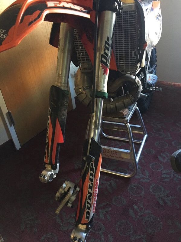

I will never use Pro Action again, especially the one in Airdrie. just had my fork rebound nut on the inside fall off while 18 hours from home in St. George Ut. its supposed to be peened. took it to Dicks Racing in to get fixed and he was NOT impressed with the quality of the work in there. long story short, he found a few things wrong and recommended I use someone else from now on. dont have to tell me twice.
