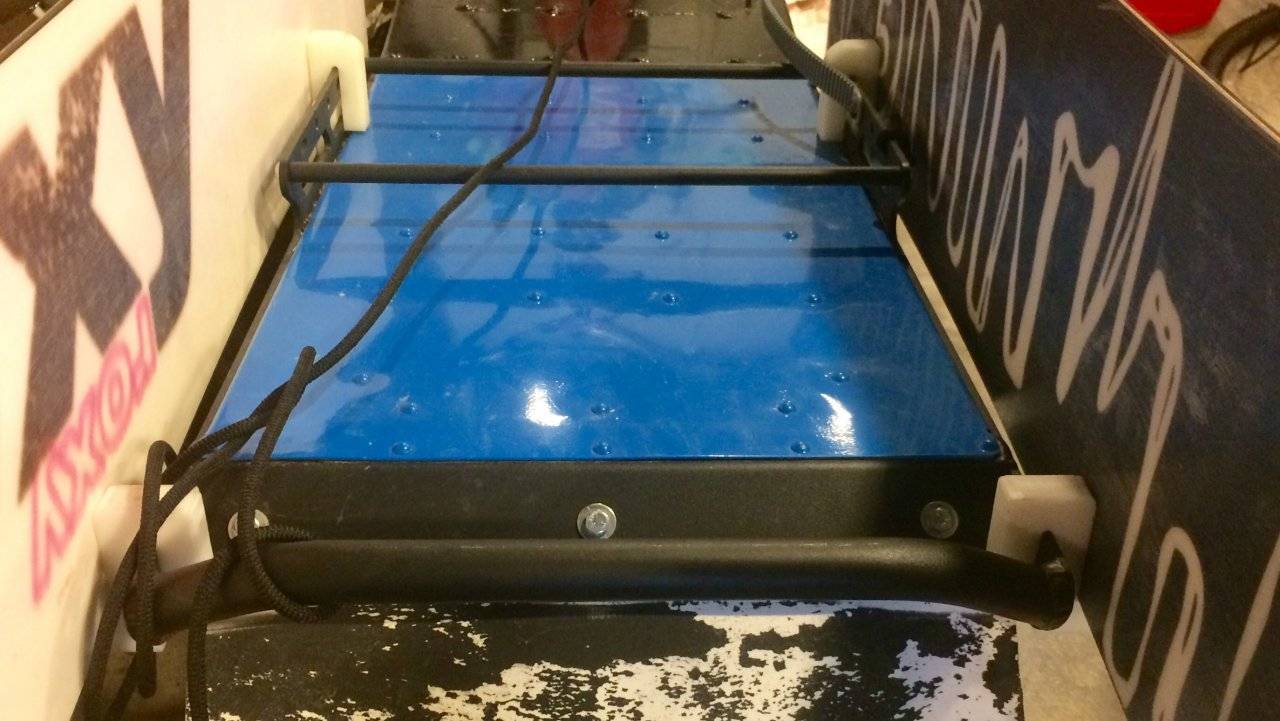

Best picture I could find of my rack. Homemade, mostly 1/2" square steel tubing, uses factory/existing bolts, holds 2 pr skis/2 boards, or 4 pr skis, stacked in the middle. All behind the seat, zero running board interference,, only downside is that you have to be careful doing 3 point turns in the woods, it is LONG with skis on it.
I like it. Starting its fourth? season, mostly original used snowboard binding straps, it is bomber.
