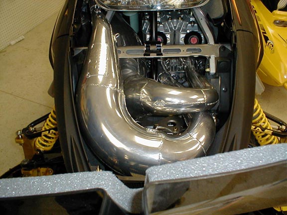

After talking with some guys on Dootalk and showing pics I think I got the wrong pipes.
Here's mine.
Here's a set of Mondos.
They sure look a lot fatter don't they.
Here's another pic
If you look at the at where the spring connects the two pipes in front it's not in the same spot. Mine is angled and the mondos it looks almost verticle.
Plus I don't think ceramic coating takes up that much more room.
