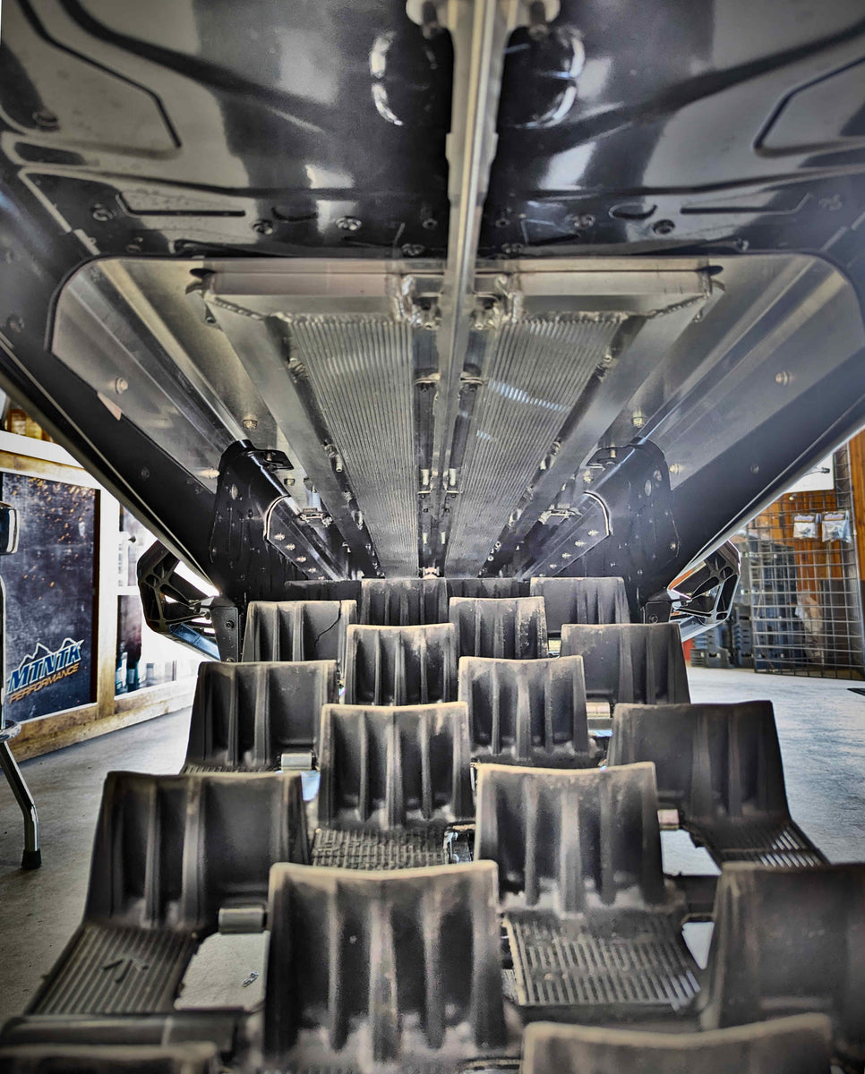

I have installed two of these now on Matryx Slash's and temps have gone form overheating to 95-115 degrees running in Sierra Cement.
meathooker
Jan 4, 2008
1,661
627
Boise, ID
Looks like a nice part as always from Mtn trek but an 8lb weight gain is hard to stomach
  • Like
Reactions: J40
