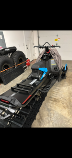

If your good with a tape measure and have access to some basic metal working tools you could do what I did.
I transferred the attach brackets to 3/16 aluminum then cut to approximate size and drilled in factory locations, drilled and tapped for mtn addiction skidoo mounts. I did have to trim because the tunnels are 16” wide compared to cats at 15”
