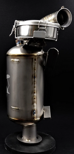

Looking at the Diamond S Titanium Quiet Lightweight Silencer.
Does this heat up the food inside very well?
Doesn't look like the cooker makes much contact with the can.

Just buy the can without the hot dogger bracket, then clamp it on the side like we've done for years. That's what I did, works well

I found that if you put your food in when you start your ride it does a good job. You can leave it on all day and not ruin your lunch, just don't expect to cook it quickly. I'm happy with mine once I figured that out. The food is plenty hot
