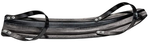

About 13 years ago I used Thompson's water seal on the wood, then Cut Plastic bed-liner (about $25-50 for a used 8 foot bed liner) Cut 7-8 inch strips out of the bottom of the bed-liner and used a map gas torch to mold them to fit my 4 sled's skis, a hole in front and one in back for nylong rope and carabiner and pull that up on top of the a-arm to hold it in place. - I have seen these for sale as well, but this was way cheaper for my 4 sleds. 8 covers (I also use woody's hard face vs. carbide's, so that helps life of the plastic too).
I put them on before I enter the trailer and once they exit to snow leave them on in the garage when doing maintenance. They last about 5-10 years before the carbides start to get through the plastic. I have not done this but you could also poor some appoxy in the groves to create a wear layer.

I have used SLP Ski Skins for many years. Put them on to drive in, then take off and slip them on backwards if you need to back out of a trailer.
Had the same pair for over 15 years - still work great!

Kind of along the same "budget" thought as the post above . . . ^ ^ ^ ^
Yes, these are what gave me the idea. I pay $25-40 for a good used bed liner on Craigslist. It makes about 3-4 pair. it would cost $400+ to get 4 sets of these. I saw them on Amazon if anyone would prefer to purchase. Amazon product ASIN B07KTF49RM

I have no problem with DIY'ers using bedliner to save a buck, but by the time I factor in my time to round up a bedliner, fab the units, and get rid of the waste I'm personally ahead purchasing them. The SLP units are quite a bit thicker material too to hold up to the carbides.
I use the SLP ski skins as well in the garage and to keep the bedliner in my truck from getting cut up. Used to use them (and similar product before that) or wheels in the trailers. I didn't mind doing that, but it seemed friends were more reluctant to want to cover their skis every time going in and out. Especially having to remove for the next person to use. After pricing out grip glides for the floor I bit the bullet and decided to go the new oil based paint covered with tiles route: https://www.snowest.com/forum/threads/finally-got-my-decktred-installed.458072/
