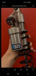

Customer service at enzo is way better, before and after the sale. They both have a nice ride in the " ride zone" but the enzo setup i can make alot more stiff when I need it. And the clicker adjustments make a bigger difference on the kyb. Also enzo has this fantastic front track shock that controls ski lift, I dont need to use the adjustable limiter strap and loose front skid travel.

What do you mean by you can set the ski lift with the front track shock? The FTS doesn't control weight transfer, unless I guess you slowed the rebound way down and even then it would need to be in a compressed state to get that effect. I know you can stiffen up the FTS compression to sort of hold the front end up and dangle a ski or stay on edge easier, and that's usually along with softening the rear track shock compression or the torsion preload. But I would love to know how the FTS is controlling transfer like you are saying.

Look at the enzo shock in the pic. The front track shock has that adjustment. The red screw (tension) is whats dialed in and out for transfer control.

Ahh interesting, so it is a rebound adjust then. I guess that makes sense now that I think about it more. One issue I would see with having your rebound set super slow (for slow transfer) would be the shock packing up in the whoops (not recovering fast enough from repeated hits). Have you ever found that to be a problem? What settings do you tend to run in terms of closed vs open and then where do you put your limiter? The other question would be if you do have it set very slow does it make the initial ski lift too slow? I feel like I want some initial ski lift but don't want to wheelie over backwards all the time so the stock rebound plus a limiter works well for that, but maybe that's just what I am used to.

There is a setting for trails and a setting for trees in the setup sheet.
